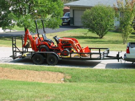

Here is what I have. See photo. As for tying down, I use 4 10,000 pound straps, one on each corner of the tractor. Brakes on each axle, 6 ply tires. (something I need to do). That is 16' flat with 2 foot dovetail, and very sturdy ramps.

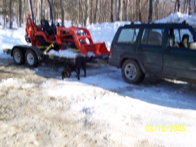

Dont stress too much on the tow vehicle.I haul mine up steep treacherous grades to my mountain retreat,here in MAINE ,with my jeep cherokee 4 by 4.Hauled bota,bucket of flat rocks,extra fuel,14ft tandom,tools etc,last trip.figure im pulling 5000lbs plus with my straight 6.
A nother feller told me he hauled his bx-23 with a little gmc pick up.A good safe hitch,well maintained buggy,and id attemp it with a 4 banger if i had a low gear for hills.them load distrubution hichs are nice they say,i aint got one,the bota gives me perfect tounge weight. nOTE THIS PICTURE WAS TAKEN WHEN I MISTAKENLY USED THEM WIDE HEAVY RATCHET STRAPS,ALMOST LOST HER,DONT DO IT,INVEST IN THE CHAIN BINDERS
ALAN
