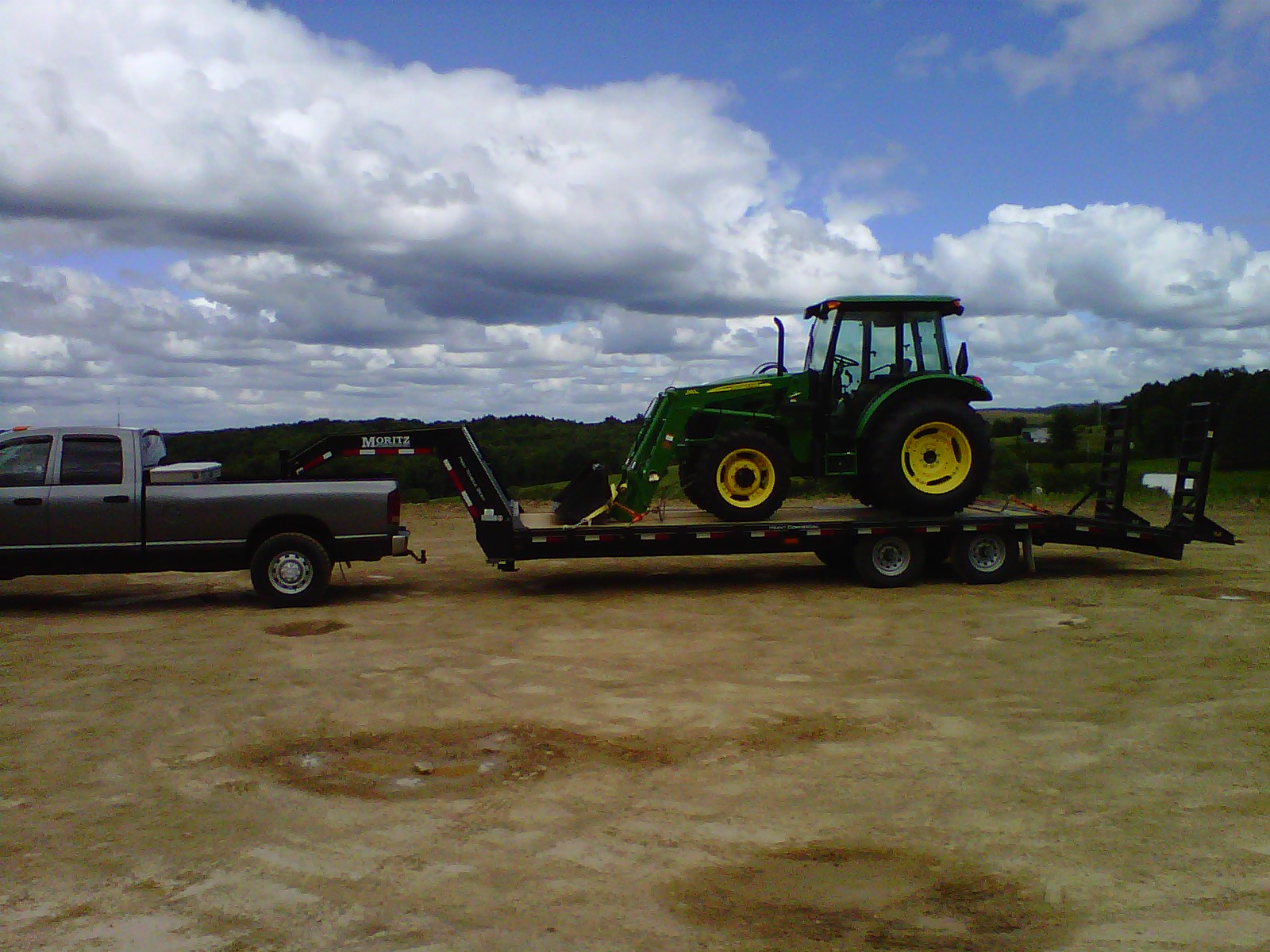

I'll tell ya what. I have an 05 SRW 3500 cummins and a 20+5 Moritz gooseneck that I tow my 5083E with the loader and loaded tires. The trailer is rated at 14.5K and the truck has air bags under the rear. Please let me be clear.
DO NOT ATTEMPT WITH A BUMPER PULL WITHOUT A W/D HITCH!!! Even that might be mildly crazy, I don't know if I have ever seen a BP trailer for more than 12k lbs unless it was a pintle hitch behind a tandem towing a backhoe or dozer.
I have SWAGed my weight at around 10,500 when I picked it up, boy was I wrong.....
-Tractor-7,435lbs
-Loader-1970lbs
-Ballast(Mine has all 4 tires ballasted with Beet juice 12lbs/gal)-2328lbs
Total-11,733 w/ballast
Total-9405 w/o ballast
If your going to put the money into a trailer you might as well just get the gooseneck. It is a night and day difference how the trailer pulls and how your truck re-acts to the weight. If your planning on getting a GN, make sure you do some measuring/figuring. My combo fills my trailer pretty well but a brushhog would kill the rest of the space I have left on there. That loader is alot longer than people give it credit for. Just my $.02 Oh and the tuner sure makes pulling that weight alot easier!:thumbsup:
