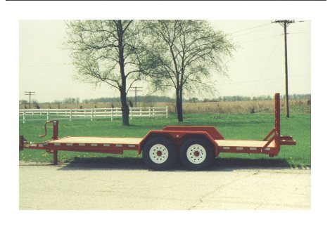

I use a 20' Corn Pro rated for 12k gross (an 18' is pictured). It has two 6k Dexter torsion axles. The ramps fold up as pictured or can be stored on either side of the back of the trailer. It has heavy gauge steel diamond plate fenders that you can step on and not worry about it. It also has a 12k bulldog drop-leg jack, full length rub rails and stake pockets.
I like the 20' trailer because I have plenty of room to stow an extra implement on the front if I need more than one for a particuar job. I like having open sides so it is easy to load pallets of sod or block. Having the extra weight rating didn't cost much more and it is a nice to have piece of mind when towing. Besides, my truck is rated for a 13k trailer. /w3tcompact/icons/smile.gif
Hope that helps in your decision.
