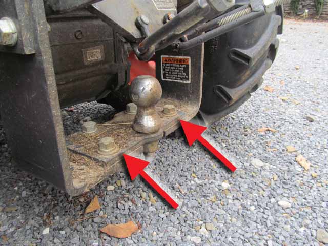

Before I jump into another project, does anyone sell a longer trailer hitch thingy that would make it easier to attach a trailer? It's a struggle getting my ATV trailer attached, fighting with the 3 point stuff. I have a piece of steel but it takes forever to drill those big holes.
Had you considered mounting the trailer ball onto your 3PH assembly?
Here's how I did it using spare parts lying around my garage.

That's a different twist and a possibility. That upper arm would stabilize things. The setup I came up works pretty good.

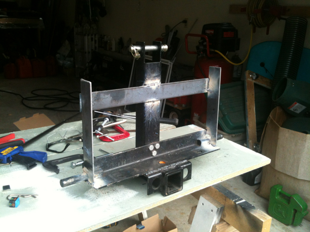

Here's my version. Welded on the upper crossbar so I can hang suitcase weights on it. Holds 3 weights on each side. Figure about 280 lbs total. The 2" receiver moves my trailer around without getting off the seat.

Wouldn't one that bolted to the drawbar let the 3pt lift arms interfere with the tongue on the trailer if it had a A frame tongue?
