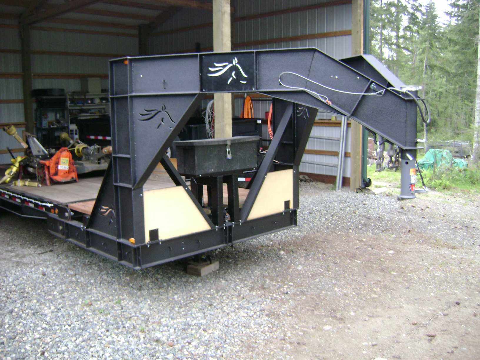

That was so long ago I don't remember a lot about it. It does look like 3/8-inch material. I think the pipe was 4-inch, sch 80.
I don't know the weight rating, but Jack has a L3200 Kubota tractor with all most 2,000-pound counterweight. When he got home he hooked up his flatbed trailer, backed his tractor on the trailer, and bounced the counterweight a dozen or so times. Then placed a straight edge on the stinger part. Looked good to him.:D
No I'm not worried about liability issues at all. These are nothing compared to what I use to build.

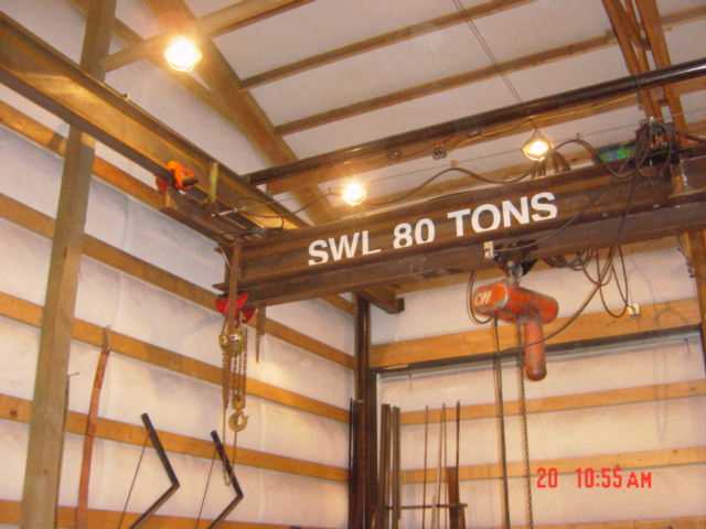

Sure I don't recommended everybody build a trailer hitch, and especially with a 120-volt Mig welder!:eek: When ever I build something I'm not sure about, I know lots of engineers that I just e-mail a drawing to, for their approval. Like this bridge crane I built for my shop, I designed it, but the head of the engineering department of the company I worked for approved it. Just like this gooseneck adapter I built, approved by an engineer. Like I said the welding is the easy part!;)

That overhead crane would look awesome in my shop. Nice. ;)

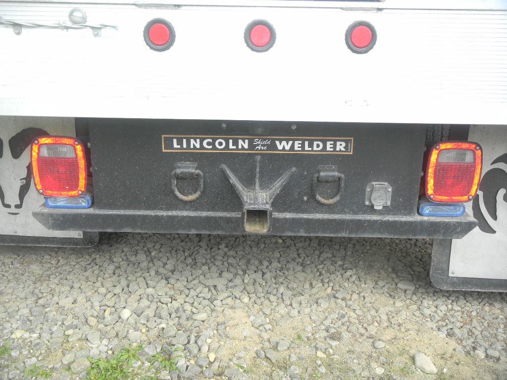

Here are a couple of the last hitches I've made. And an extension for a friend. I wouldn't use that thing, but that's what he wanted. :laughing:

You sure that will hold? :laughing:
   / Trailer hitch question? #39
I think it puts too much leverage on the receiver myself! But he likes it. He says it helps to back his boat around the corner of his house.:confused3:
   / Trailer hitch question? #40
SA, on that first one, on the Ford truck, does the tube extend further back to counteract the leverage, or is it welded on to the plate that is visible in the photo? No gussets or anything? Coming from a woodworking background, I constantly have to rethink how I design things with metal. Something that, with wood, you'd need a ton of bracing/gussets, with metal, you just take two pieces, weld them together, and call it done. But I'm never sure just how far that principle extends.
