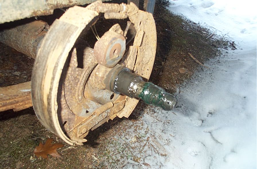

I agree about highway re-use of MH axles, but I don't understand the backing plate issue.
I've never had to replace a backing plate on a car, truck, or trailer when doing a brake replacement, and I don't know anyone who has. Every other part, but not the backing plate.
Sometimes I see a case of a drive axle shaft or trailer hub/spindle breaking, falling off, and dragging the axle a couple hundred yards down the road on the drum and backing plate before stopping, but that isn't a maintenance item.
Is it really that common to be a concern?

I don't see the backing plate issue as something the manufacturer is concerned about wearing out itself and not being replaceable, I see it done more as an "in-your-face", really obvious visual indicator of how limited-use the intent of the product is. If they make and sell an entire replaceable brake assembly for the rest of the line, and they don't with these....they want folks asking themselves why that is.
Not only does the welding-on of the "backing plate" drive the limited-use, non field-serviceable point home, but look at an example of a MH axle "backing plate" itself. Wide-open, exposing the components to more debris, contamination, and corrosion. I'd say an assembly like this is built to a price point first and foremost, and intended to look like it was built to a price point as well.
