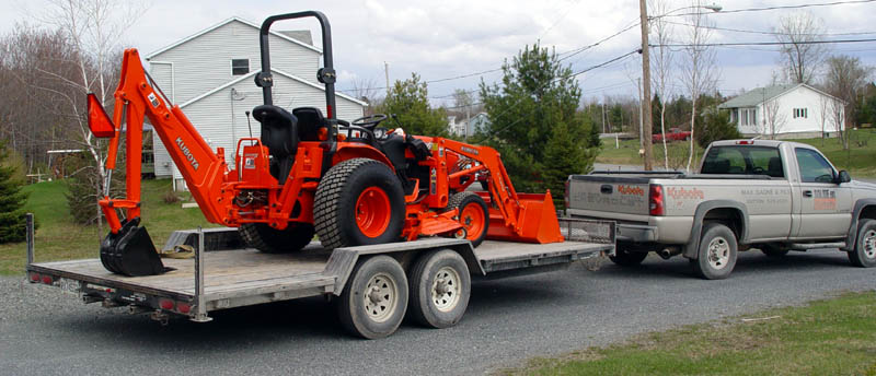

Yes, I tried and it's very smooth. But I didn't worry about that because last year I loaded a pallet of stones (4100 lbs) and it was ok (I was a bit over recommendations though). I have a load "limit" of 5000 lbs for the truck and 7000 lbs for the trailer. The trailer's weight is 1200 lbs. So I'm ok. About the vehicle, it's a V8 engine 290HP (at the wheels). The truck's weight is around 5000 lbs and the breaks on the trailer do a great job. That's what I like with Kubota, I don't need to change my truck to get a powerful tractor as a B3030. I looked at Case and John Deere... Ohh boy... we're not talking about the same weight. But I don't need a heavy machine.
I chose 16' last year because I owned a BX23 at that time. 16' for a BX23 is great. 16' for a B3030 is a bit small.

Definitely, 18' is a better choice than 16'. I didn't know until I tried today. With the backhoe on the bed you won't have spare room. If you swing it you'll get an extra 32" maybe.
   / Trailer length for B3030 w/FEL & BHoe? #13
I agree with you DaNag. I had a 16' tandam with the lift gate that I bought a year and a half ago. I knew, then, that I was going to get a tractor down the road. The problem was, I bought a larger tractor than I anticipated. With the FEL and the 5' brushhog on the B3030 tractor, I needed 20' to fit with no hassles. Thats what I got. I could have bought an 18' or even put the bucket in the air to fit my 16', but the 20' wasn't much more. It will fit larger tractors if needed, down the road. I can put other items on it if needed. I went ahead and got brakes on both axles and the last two feet are dovetailed.

I'm sorry, in my first post I talked about the trailer of my dealer and I just saw that the pic wasn't there.
Here it is... the guy told me 19'. It must be 20' (19'?? I've never heard of that length).

I have the same set-up and use a 16" beaver tail ...works pretty good.
I want to get rid of the equip trailer and get the smallest low profile dump to take it's place.
I pull with a 2007 F150 5.4L 4x4 so I want to keep it as light as possible.
The Tractor, BH, & FEL are approx 3800lbs.
It measures about 16' from the front of the FEL to the back of BH.
I think I can set the FEL on the front of the trailer, Leave the barn doors open and turn the BH.
What would be the smallest trailer I should consider?
6x10, 6x12, 6x14??
7000lb, or 10,000lb?
