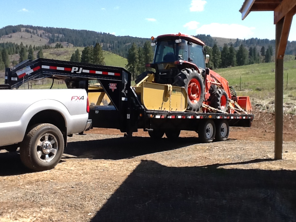

Dave,
This is a GN, but it is a 14k, 20', and the tractor load on it in the photo is 21 OAL.
