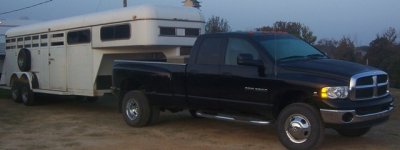

No Jim, Nothing lifted or no monster tires, we do have a few around Oklahoma that way!
I think a combination of a 10-15 yr old trailer, 15" tires and todays Trucks they just don't go together with out doing somthing. As the Dexter axle website stated, with todays tow vehicles you may need to raise the trailer.
Have you seen there over/under kit? Pretty simple, adjustable spring seats that fasten one top, bolt down to the old ones, new U bolts and thats it. About $45 per axle.

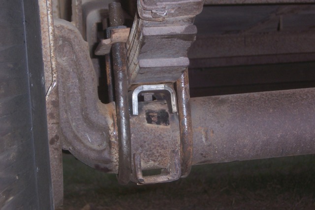

DONE! The entire process took less than 3 hrs and lifted the trailer about 6" and gave me the ground clearance. I did not go with the Dextor Kit. I went to the local shop, bought 4 of the 3" sring seats, 8 U bolts and 4 new spring Bolts, Total Cost $56.00!
Thanks to everyone for helping!!
Todd

Here are two pictures, just imagine how low it was. One of them is with it hooked to the truck.
Todd

   / Trailer lift kit? Lower Axles? Need advice!! #19
The angle of that picture doesn't show any weld and I don't see any grinding marks on the axle tube. You did weld them on, right??
Ken
   / Trailer lift kit? Lower Axles? Need advice!! #20
I wonder about that too. The Dexter kit has provisions to align the new upper pad with the lower welded ones and to transfer load to the welded one. They have a nut arrangement to adjust.
Instructions here- http://i.b5z.net/i/u/1080235/f/059_551_00.pdf and a picture of the kit here-Dexter Axle - Trailer Axles and Running Gear Components - K71-385-00 Over/Under Conversion Kit
even with the kit they still strongly recommend welding.
If one just uses spring pads and not the kit they must be welded. Blue river- please tell us they ARE welded:eek:
