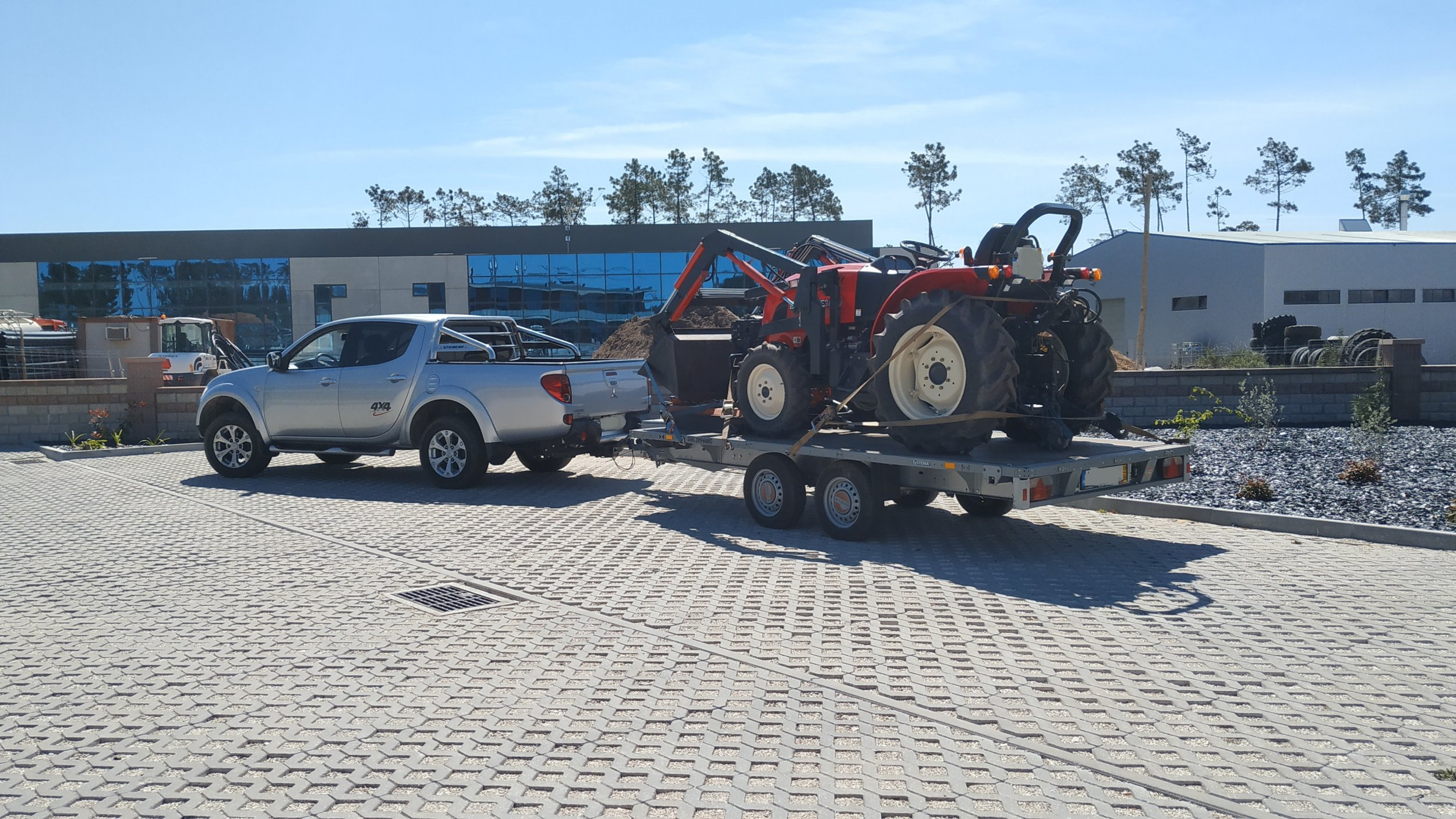

Hey folks—
I’m finally going to me moving the equipment on a regular basis…
New property is 25-30 miles down the road so I’ve bought a nice 16+2 trailer.
6k load rating for my L3400, did the math and it should be less than 5k with that I plan to move regularly..
But I do have a few thoughts I want to ask questions about…
The plan is to put the bushhog on the front 5 ft of the trailer- then raise the loader up, drive the tractor forward until the front tires hit the bushhog… and then lower the loader on some kind of wood base that will allow it to rest on top of the bushhog with a beam wider than the bushhog.
Does anyone do this?
I’ve vaguely remember seeing some setups like this on the road.. but now that I’m doing it I can’t seem to find those examples….
Thanks
Jim

A few notes—
1. Tractor has loaded tires.
2. I moved it before with a borrowed 16ft just the box and loader. That trailer was an overbuilt landscape trailer… it had 3500 lb axles, but brakes on 1 axle only. And the tractor had 10-12 inches to spare. It carried it well… but didn’t like the braking with only 1 axle. I used 4 in strapped and not chains. It moved 25 miles each way. Down a mountain with a 6% grade on the interstate (check Saluda Grade, NC) and a crazy curvy road.
3. The new trailer has the same 3500 lb axles, brakes on both.
4. The new property is down the same mountain, but into SC.. nothing crazy on curves like lake lure on 108 and #9!
5. This will likely be a regular occurrence… BUT I might be leaving the bushhog down there… SOME..
6. I’m in the market for good chains and binders… where for a good price for good gear but not a bank breaking price.. I think harbor freight is untrustworthy… but change my mind!
Thanks to everyone for the advice and info!
