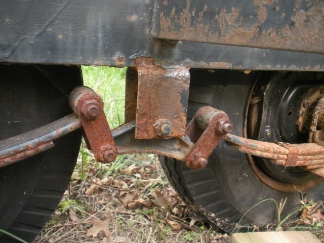

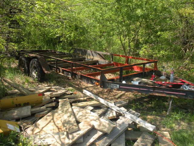

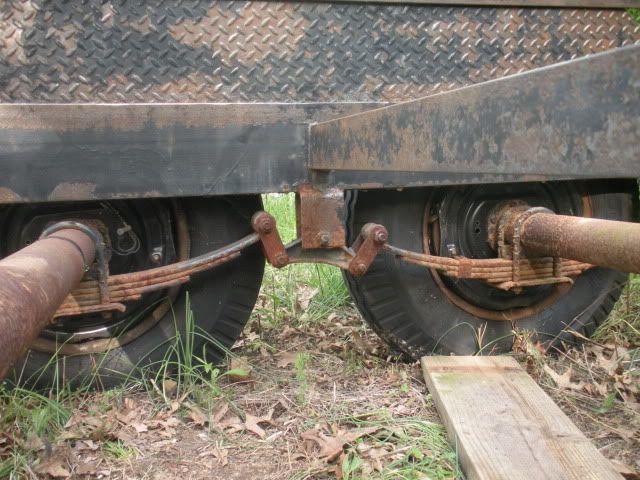

I'm in process of replacing the deck and painting an old dual axle hudson bros 10K trailer. Last year I had new wiring, and complete replacement of the 4brake assemblies, shoes, tires etc. The picture below shows where I'm at today, and am wondering is there anything needed on the shackle and suspension components as seen in the second picture. The springs were replaced by the previous owner before I bought it, and don't have many miles on them. But as you can see pretty rusty, which I will address. Not sure of the terminology, but would the bolts which connect each of the leaf assemblies together via the triangular forging (equalizer?) in the second picture need to be removed, and greased?? Are there bushings in there which may need inspection?? This is a bit of work, so I don't want to take things apart that don't need it, when there is so much other work to be done. Thanks for any input or any other suggestions.

Most modern ones have plastic sleeves inside where the bolt goes through. You can take it apart and replace it if you want but the bolts and nuts should be replaced if you do so. I grease them before assembly if doing that job.
As for your trailer unless you see a issue I would leave them as is.

I have a 10,000# trailer. I have had it several years. I have changed the plastic bushings twice. They were completely worn to the metal. I replaced them this third time with bronze bushings and greasable bolts. I jack it up on the side I need to grease and add grease while it is up. It lets the grease get on the bottom side of the bushings. I also have grease fittings on the bearings. You have to be very light with the grease to prevent blowing the seals. That would be a bad thing with your brakes. I also have had to replace the hitch. It wore a hole in the top from the ball. I found a really nice one from Northern Tool.It is massive. It is cast steel and has a great latch on it.

I would not replace what is working, but an annual inspection is recomended to ensure you are not wearing thru. The equalizer (correct term you had there) does not normally affect proper function or safety even if worn as long as the wear does not cause loss of strength of the bolt, equalizer itself or the hanger.
