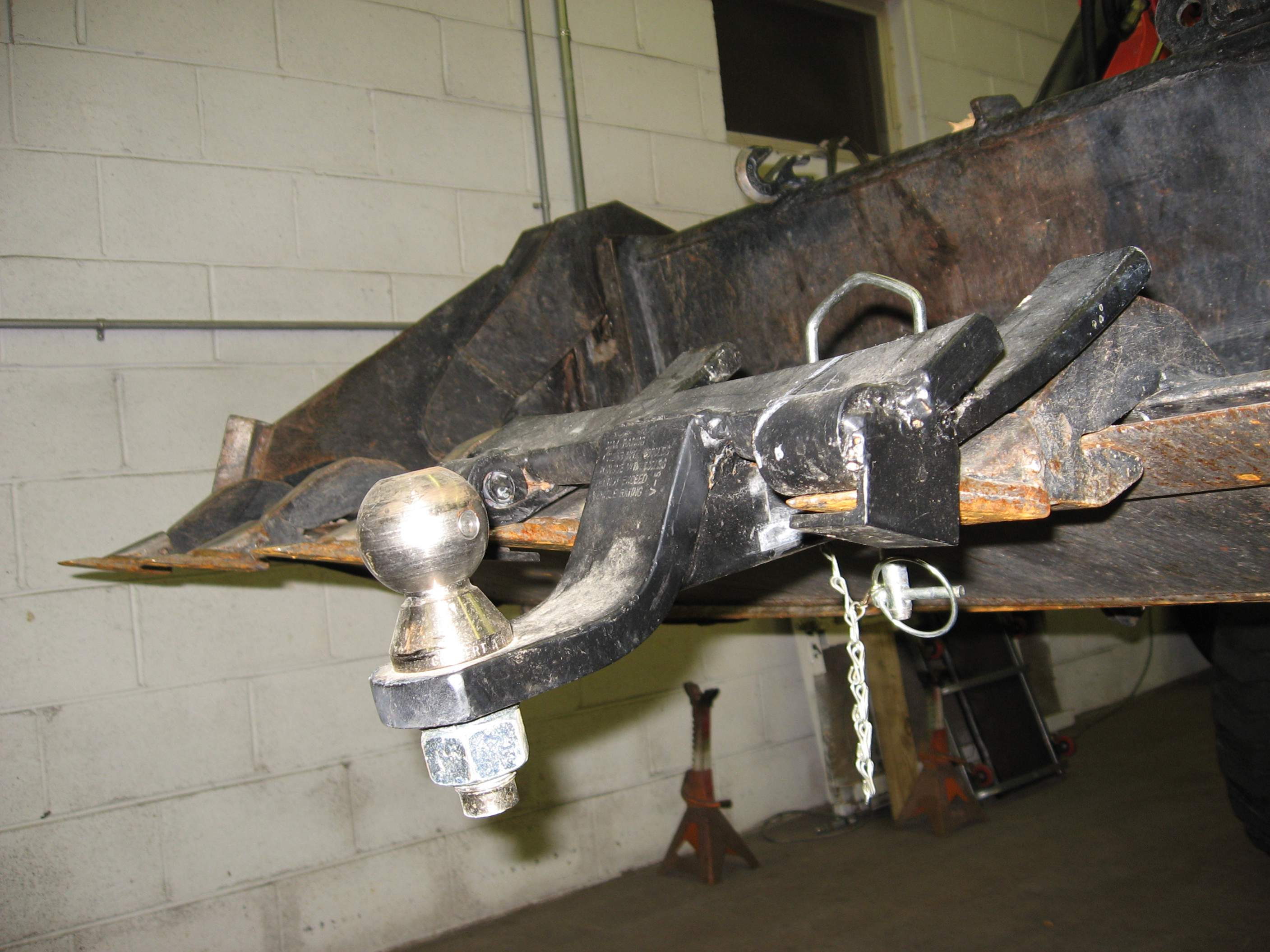

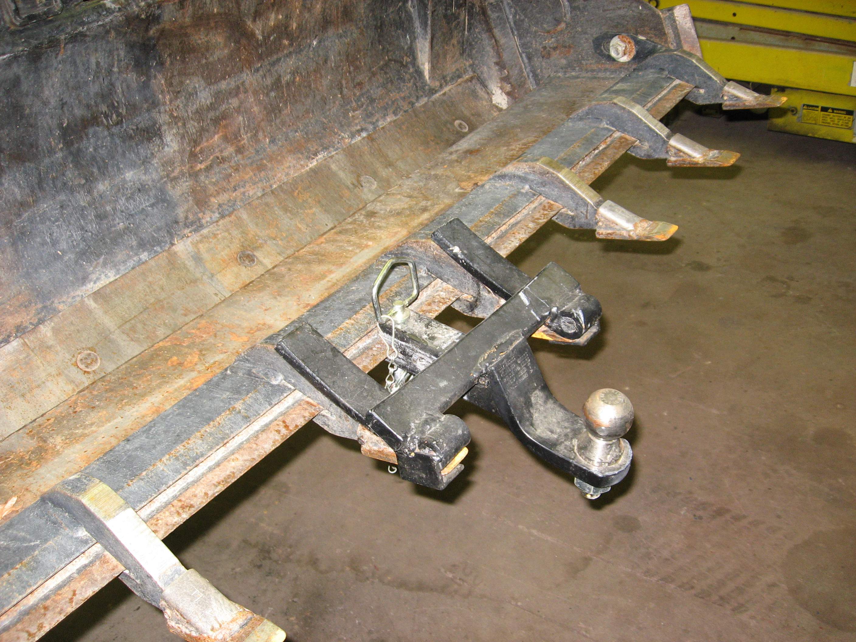

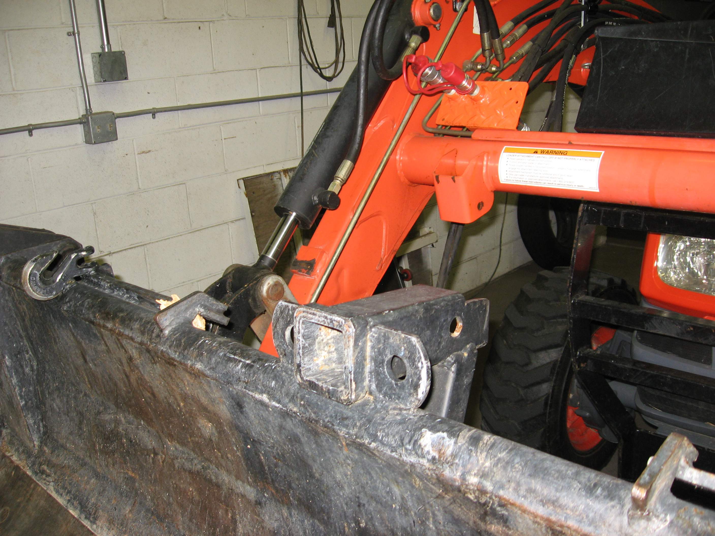

I was looking for something quick easy and no tool way to move trailers around. Came up with this as it does not require removing what is on the 3 point or removing bucket, 1 pin and move trailer. I have used it many times to move double axle car trailer and few other small trailers and works well. I have the interchangeable 3 ball system on it. I have never tried it on 2 horse w/dressing room goose neck horse trailer but believe on level ground it would work well. First one to say it is not a Heavy Duty trailer mover, but works good to move stuff around plus you can leave mower on, mow , then move trailer back. The receiver is also part on my bucket mount boom pole. One thing I don't like is when moving brush things tend to hang up on it. Critter trailer mover 001.jpgCritter trailer mover 002.jpgCritter trailer mover 004.jpgCritter trailer mover 005.jpg

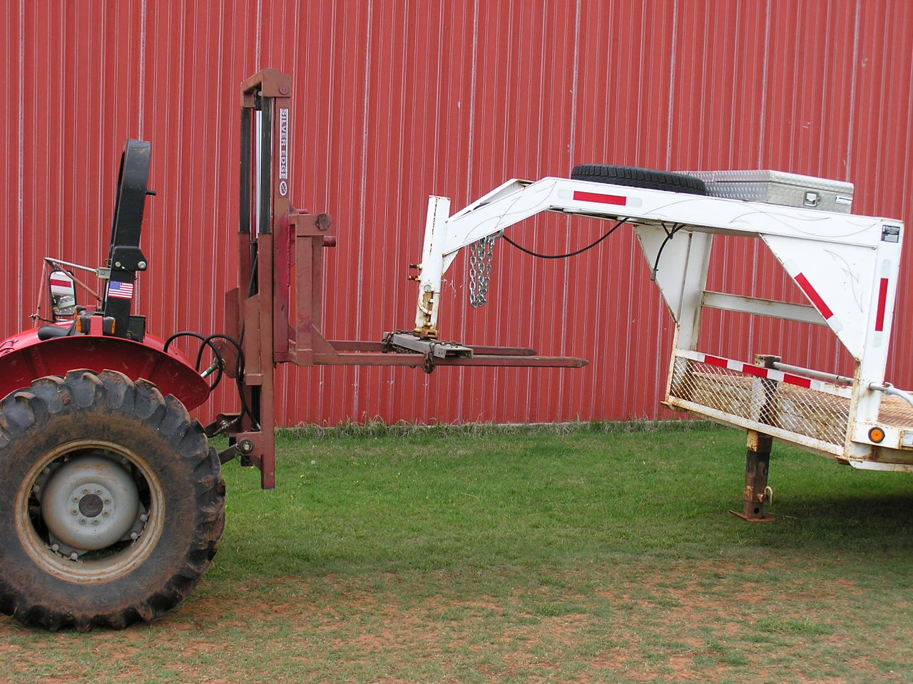

Hello I was wandering if anyone knows where I can get a trailer mover for my FEL (like the ones the trailer dealerships have) my tractor has a global carrier and I've searched all over the net with no luck. I would like one that has all the ball sizes plus be able to haul around a fifth wheel. Even if someone knows where I can get some plans to make my own would be sweet but buying one would be easier if possible.
Thank you.
Corey
This is the what he has on the FEL:
This will fit, from: Worksaver Pallet Fork Attachments
This company builds attachments for GC: Hay Farm Equipment | Skidsteer Attachments | Hay Spear Attachments
I used a piece of channel iron with a 2 5/16 ball to move my old gooseneck.
