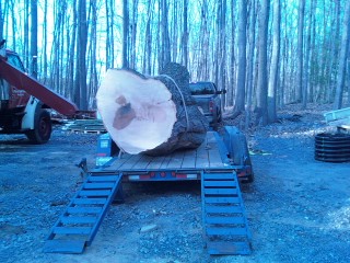

I'm surprised it didn't bend the spring hangers or break the springs before frame would bend. plowking
   / Trailer overloaded, you think?? #12
It comes with hydraulics at least partually. You are less aware of the weight if hydraulics does the work for you.
   / Trailer overloaded, you think?? #13
Looks like the loader only had the one place to put it and I'm guessing that nobody thought it was that heavy. I don't know what that loader can lift, but guess it has a 3 yard bucket on it, which should be in the 12 to 15,000 pound range. The log wasn't a challenge for it, but placing all the weight on the front of the trailer was.
In all honesty, I would probably done the same thing. The loader looked like he did a nice job of being gentle with it. If I wanted that log, I might be the one in that position. Hindsite is pretty easy when you see others mistakes, but I'm not experienced enough with big logs like that to know what they weigh or what the damage would have been.
Bending the frame on the truck just would never have entered my mind. I'm still amazed by it. The trailer, well that's fixable and sort of meant to be abused, so that's what I would have expected to be damaged.

Eddie, I'm surprised at your comments - but you have a lot more experience than me so maybe I would have done the same (don't think so though). That tree is a monster.
Once my buddy saw two fellas drop a tree stump (probably 10' high or so) into a truck box. Crushed the truck like crazy. The tree was not as big as this one but it was still darned big. The guys told my pal to stay out of their business when he suggested they not do it.
Oh well, we all live and learn!

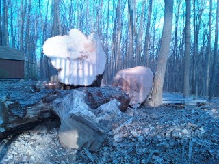

you know i just brought home a bunch of logs like that yesterday myself. they ranged from 5k to 10.5k! there is no way i would put that on a 1/2 ton. i too two trips with my 3/4 ton and then used a tandem axle log truck to bring the biggies...it was still an effort to get them home safeley.

the trailer in the pic is 5 bolt axles. 3500lb'rs
while the trailer may take more weight (if loaded right) the axles wouldnt. with a trailer weight of 2000lbs your looking at a rated playload of only 5K lbs.
could you stretch that shure. but my guess is that log was over 10K lbs.
had you had a 10K lb deck over trailer, and loaded the log right, my guess is you wouldnt have had any problems. (but 1200lbs is a lot of tong weight for a 1/2 ton pickup)
