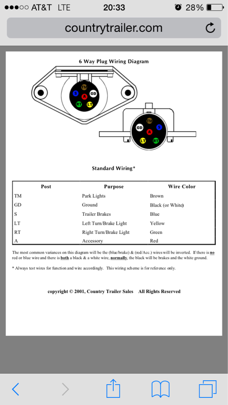

Thought maybe I could figure out wiring to trailer plug on back of my T450 TYM to power LED lights mounted to ROPS ( but wires are SO-O-O buried )...I would like to get male plug to wire up with LEG pigtails and just plug into female plug when needed. Anyone done something similar...where to get male plug to do it???

How many prongs on the plug?

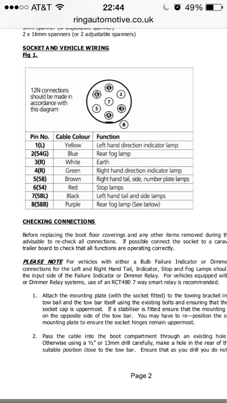

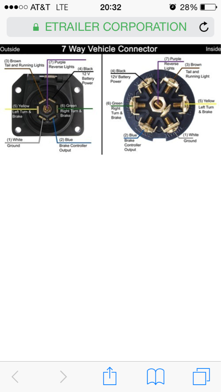

7 - 4 male/3 female...all round ( 3 female in line/ 4 male in X pattern around them)... my plug only says- Made in Deutschland -on it

Holland plug. Also used on semi trailers.
