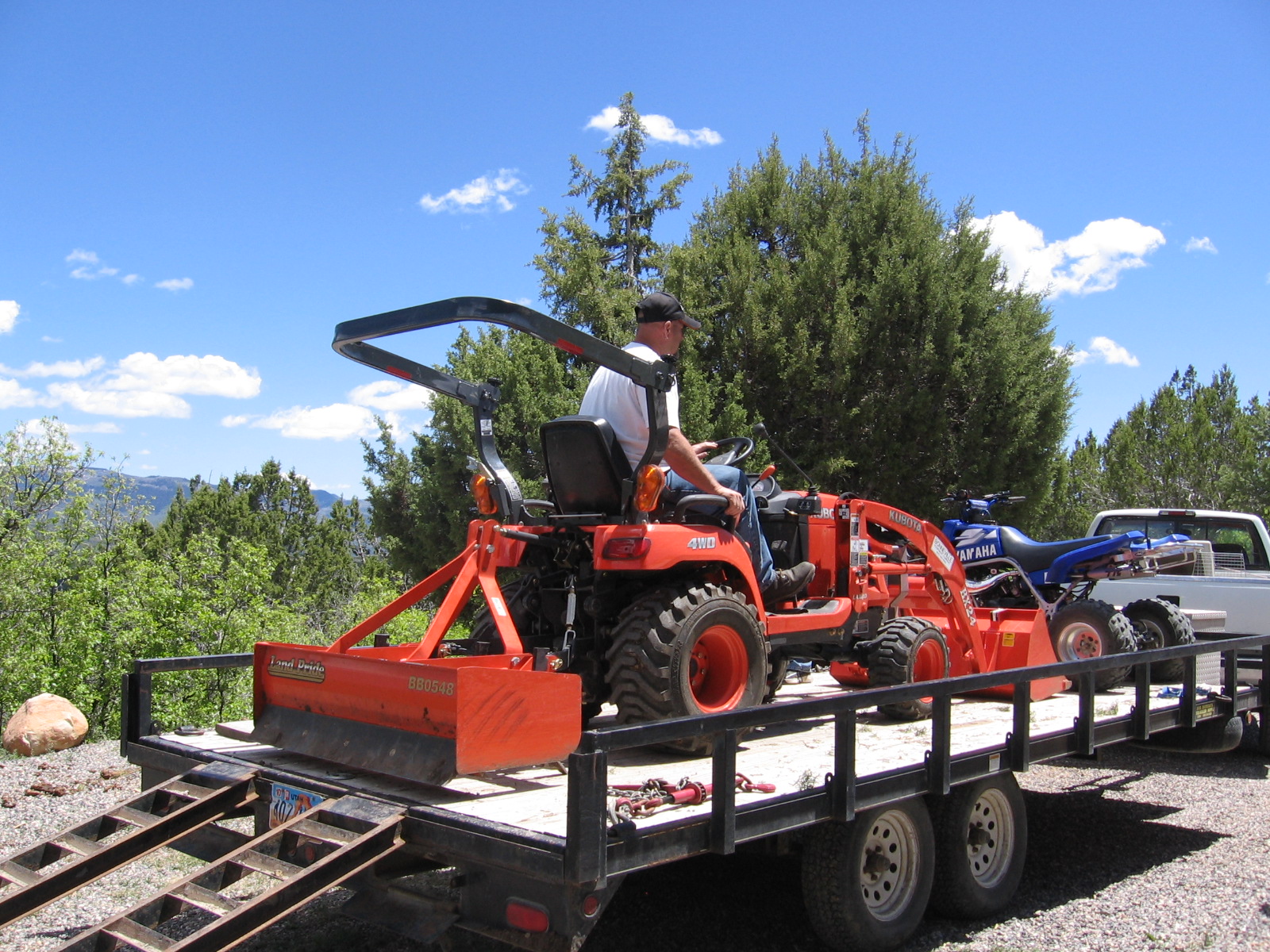

I have attached a photo of the new BX25, just after it was loaded on the trailer after we bought it. As you can see, it fit on the 5' X 10' trailer quite nicely, and with the extended receiver hitch, there was enough clearance in front of the FEL so that the truck would not be scratched when turning a corner. As well, the trailer os low, which keeps the center of gravity low, and thus it was very stable on the road. (We just went a little ways, to my cottage, but it felt very good with my F150 as the tow vehicle.) :cool:

OKay, so here's how I fit my BX25 on a 5' X 10' trailer, with room to spare for the ramps.

Perfect example Check of thats all you really need. Since most of the BX models have a bellymower, no problem there. And if you had something else, you can always put it in the back of the truck.
And you are also right that it's noce to have a trailer that you can move by hand or ATV. Tandom axle trailers can't really be moved by hand.
Yup...that's about how I remember it fitting in my 5' x 10' 3,500# trailer.
Not that it isn't great and all...I do remember being able to shove around my old trailer by hand (an absolutely impossible thought with my big trailer,as Mr. RobJ points out)...but seeing that picture absolutely reminds me of why I got the 20' long trailer.
At least you have brakes...that's a big plus. And having the dump is wonderful. I'd have to take two trips to the dealership to have my mower deck serviced...that was a pain. And I never figured a way to make the trailer feel "good" behind my truck (2005 Expedition) with the tractor loaded. Wandered too much. Tires were too "squished".
Looks like you have a 5 foot long draw-bar on your truck (I'm exagerating, but that sucker has got to be at least 2 feet long...), maybe that helps with the "feel"...funny, though. I never had a problem with the possibility of scratching the truck. When I got my backhoe, I'd load it the other way, though. Seemed to load my tongue better than FEL first.
Dunno. It's just me, but I just wasn't comfortable towing my $20,000 machine on a trailer that 'just made it'. As nice as yours looks and all.
I'm just a fan of the safety factor...150%...towing a 3,000# machine means I MUST have a trailer capable of being loaded with 5,000# of payload...add the trailer weight and you are right there at 7,000# every time. And you get two whole entire extra tires added to the mix to boot.

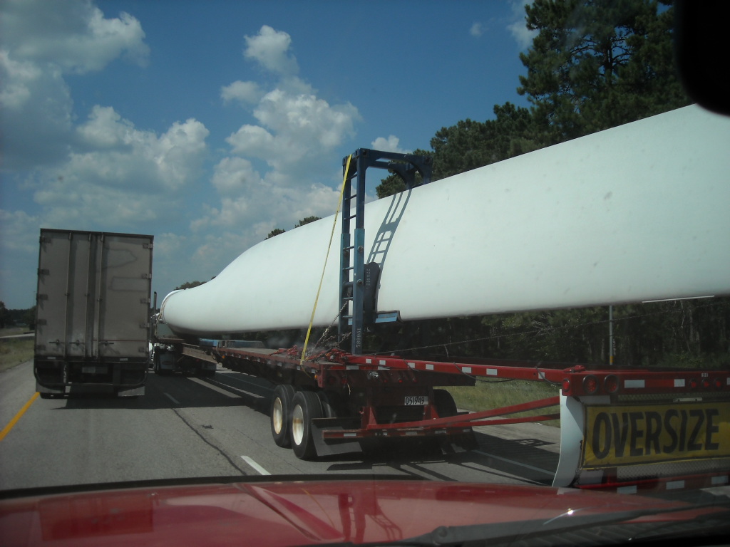

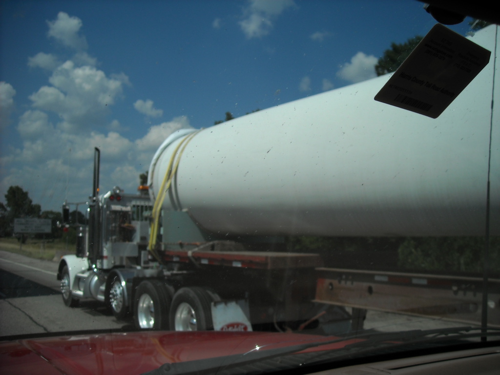

Got a link to those regs? Straps are used on everything down here. How about a 100' prop for a wind turbine? Got Straps?? :D
Rob I don't have a file on the regs and am to lazy to go looking for it. This is information I got from one of the DOT guys in the area. We have a good number of them around here because of all the pulp wood haulers in the area. Those guys push the limits often so are looked at closely.
From what I was told straps are fine for a load that does not have the possibility of suspension movement, which includes rubber tires. Everything else requires chains.
Also I am not trying to be the safety cop. I haul so little for such short distances that when I do I don't meet the regs myself. It just isn't worth the expense of a lager trailer for as little as I use it. Just wanted to point out to new users that even if you meet the weight restrictions of the trailer you are not necessarily legal. Most rural areas seem to be pretty lenient for non commercial users but I am sure some are not.
