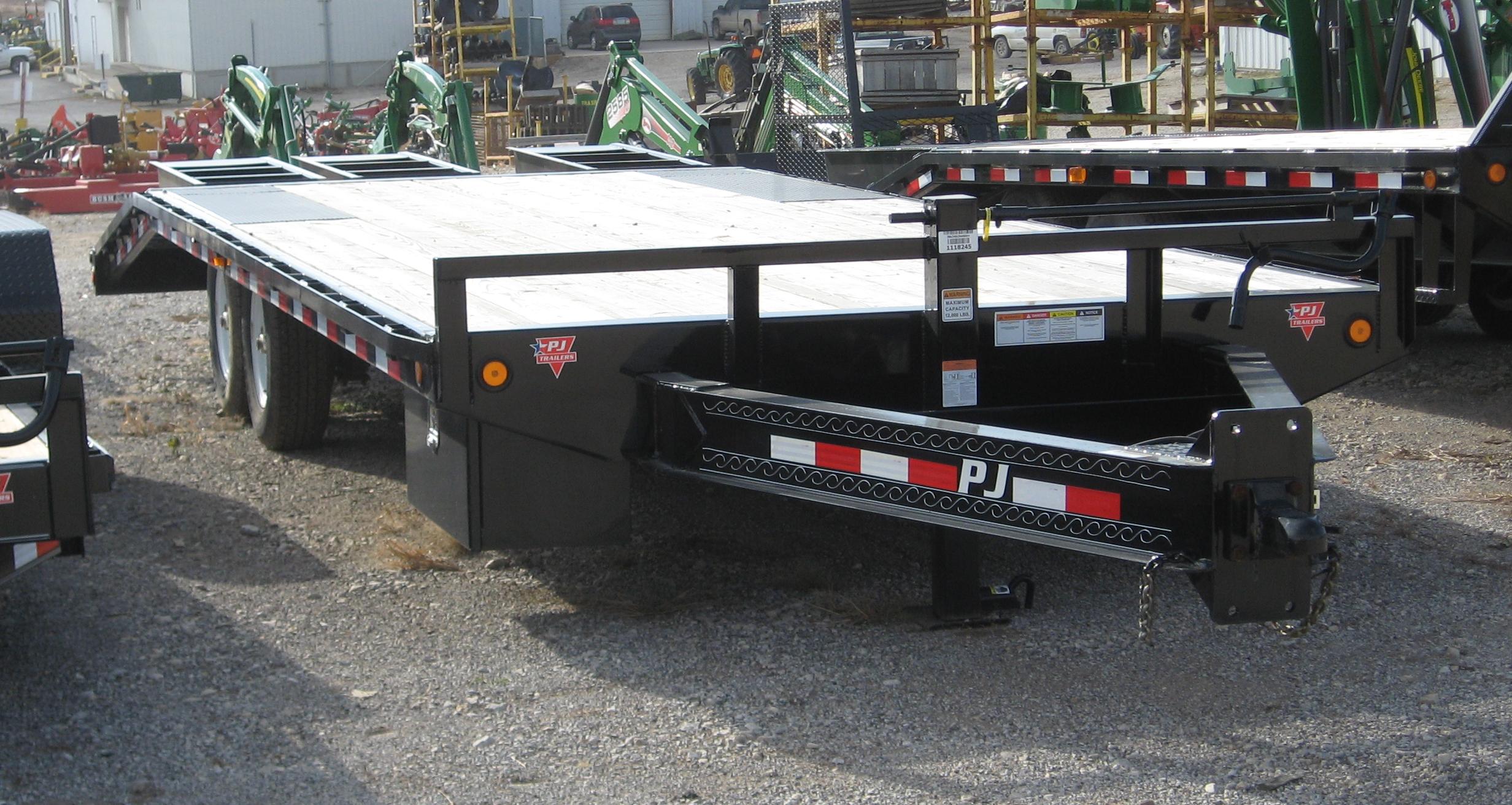

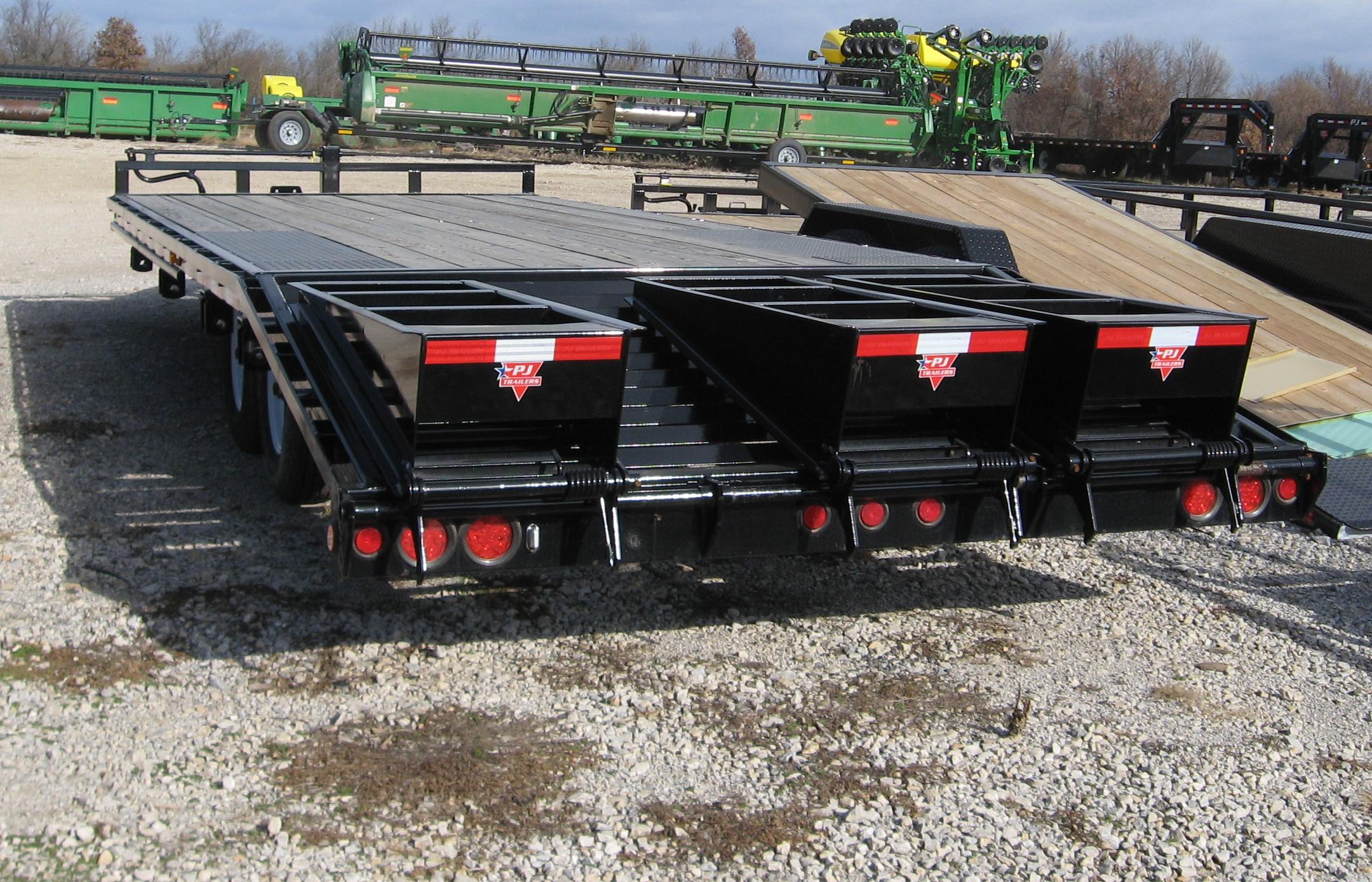

Thanks for the responses. Probably should just fab up my bracket and mount the controller before I pick it up (if I get it). Guess I'm also a little worried that I will have to be learning how to adjust the brake settings and stuff on the fly and I'd hate to screw something up on the drive home (25 miles or so) if I get it wrong.
Here's a couple of pics of the unit I'm considering. Way more trailer than I need, but I like it anyway.

That's a great looking trailer!

We prefer units with stand up ramps. They allow you to utilize the dovetail while hauling tractors and other equipment that needs to be loaded by ramps. If you have to haul two tractors that need the extra length of the dovetail a long distance, and don't want two trips, you need to utilize the dovetail. You would need to pull forward, put the ramps down, then move back to use the dovetail.
The fold-flat ramps do have pros, as do almost all things. Such as a longer flat deck. And things that are as wide as the trailer, that stick off the back, you can't have ramps in the way.
They both have pros and cons, but that seems like a good trailer for you. You only have one, small tractor that will fit with no problems. On another note, you may not want to pay for that extra ramp if you don't need it.

Stand up ramps also help you see the trailer behind you when it is empty and you are backing up. JC

I agree with the points about the stand up ramps being useful. It looks like it would be easy enough to fab up a bracket to hold the ramps vertical for those instances when it might be necessary. Otherwise, I like the idea of being able to just throw a sheet of plywood or something over the flat ramps and use the full 25 feet of flat trailer deck for moving furniture or whatever.
