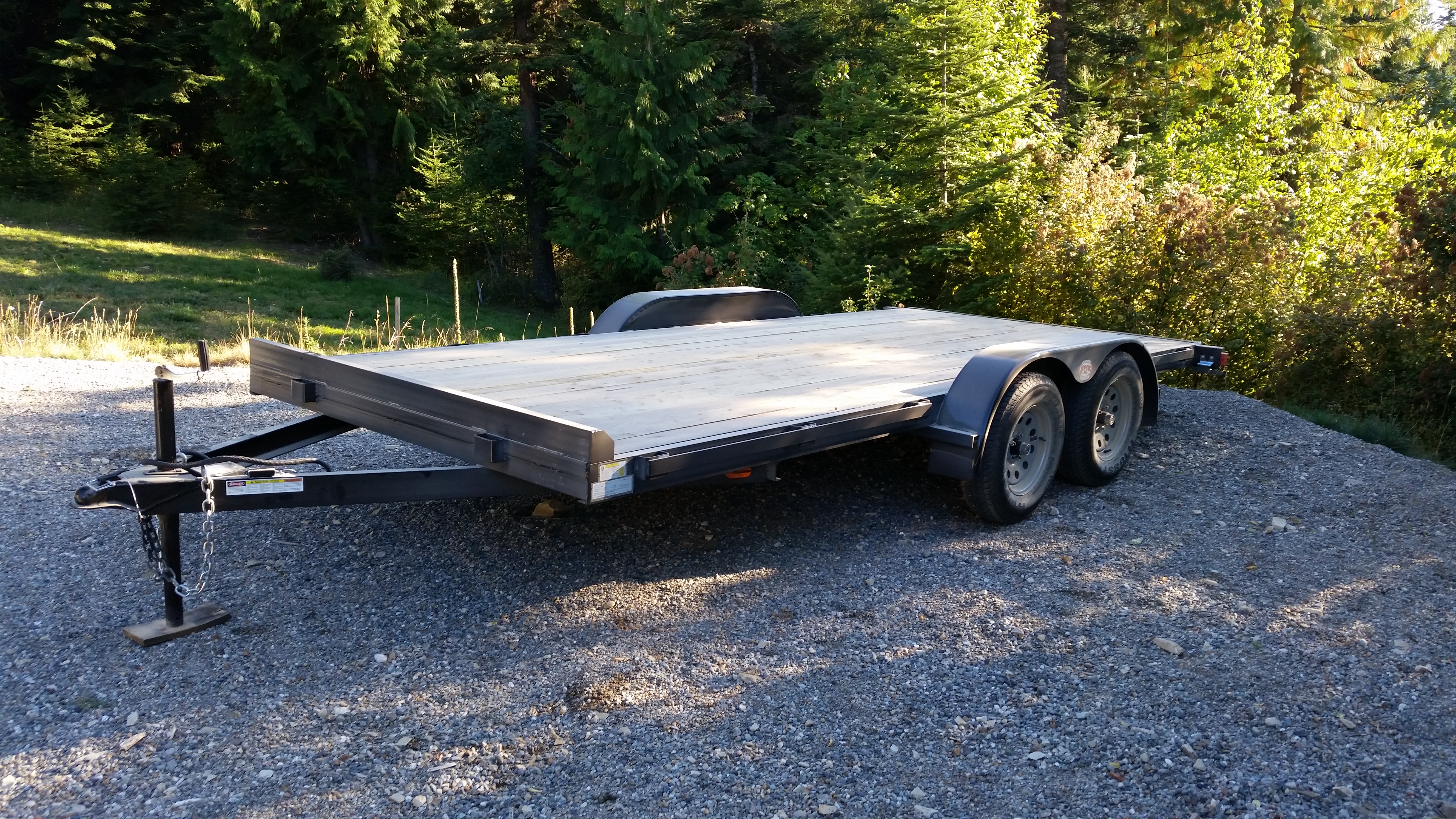

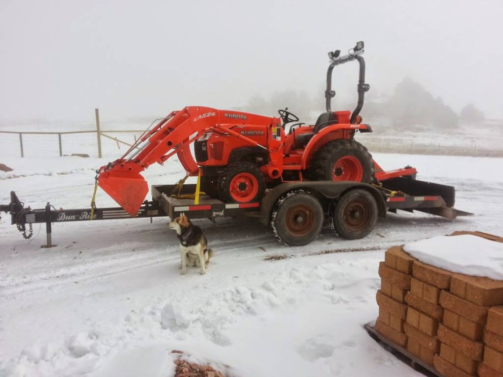

Fallon, what type of trailer is that in your photo? I am looking to get one similar to transport my mini excavator and a few project cars.
It's a Dunn-Rite. Some small outfit here in the Denver area. I picked it up for cheap at an auction.
It was your small for my needs really, but the really long tongue on it let me get 3+ years out of it. 16' deck was really short, especially given the pair of 7k lbs axles. It would work well for a mini-ex though as those are really heavy for their tiny footprint. Maybe a skidsteer. But there would be little to no room for impliments. Probably a bit short for any cars, without figuring in needing extra deck to balance things.

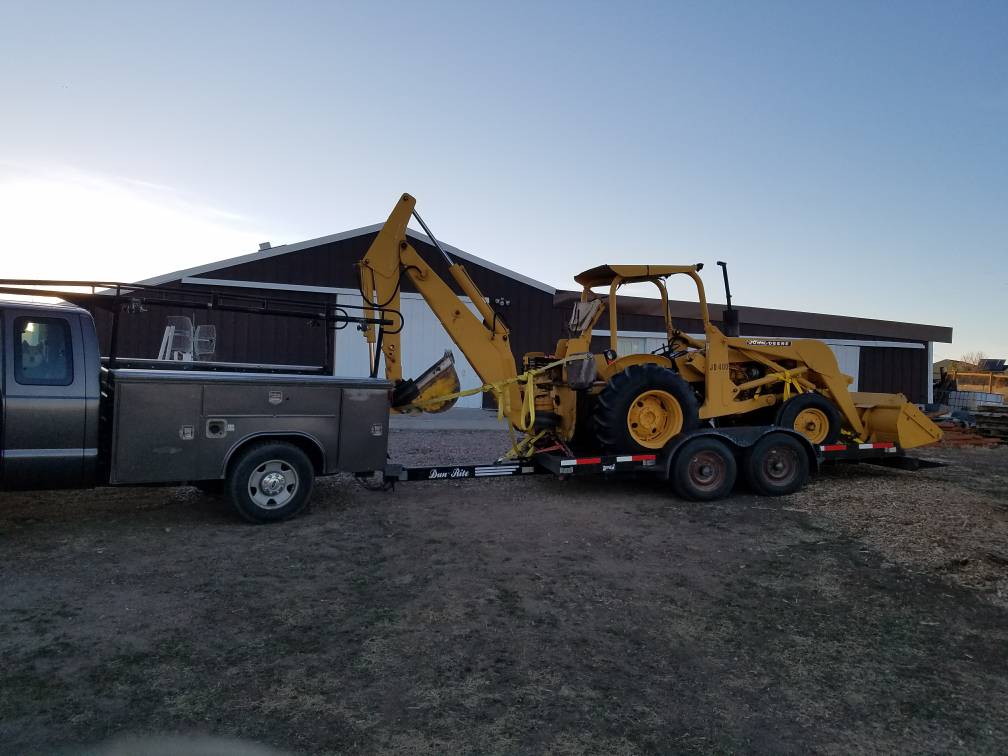

I loved the tilting deck. It made loading & unloading so easy compared to ramps. The angles were so low too, way better than my new power deckover tilting deck. Gravity tilt makes balancing your load trivial. Drive forward until the deck tilted on the pivot centered between the axles. Then scoot forward a little bit more & you got 10% of your load weight on the tongue. It definitely loaded machines easy. I went with the deckover knowing it would be harder to load machines on, but easier to load other stuff on with no tires or fenders in the way.
I did somehow manage to get what was probably a 12,000lbs backhoe on the trailer, twice. It wasn't a pleasant tow for those 15 miles, but it held up fine.
It pulled okish with L3200 behind my Toyota Tacoma. But I promptly went out & got the beater F250 after a couple hauls with the Tacoma.
Have some more photos of the old & new trailer at Trailer - Google Photos
If you are just hauling cars most tilting decks are going to be overkill, but will work well for cars & machines. The last few feet of the deck aren't suppose to be used in transport & because they pivot between the axles unloaded balance can be off. They balance evenly, not with 10-15% tongue weight. Pulling the Dunn Rite home it started swaying badly over 50mph. Stopped at a friends house, shoveled a couple hundred lbs of snow on the front of the deck & it pulled fine at 65-70 the rest of the way home. 20170909_135559.jpgIMG_20140209_103755.jpg20170315_184314.jpgIMG_20140209_110007.jpg

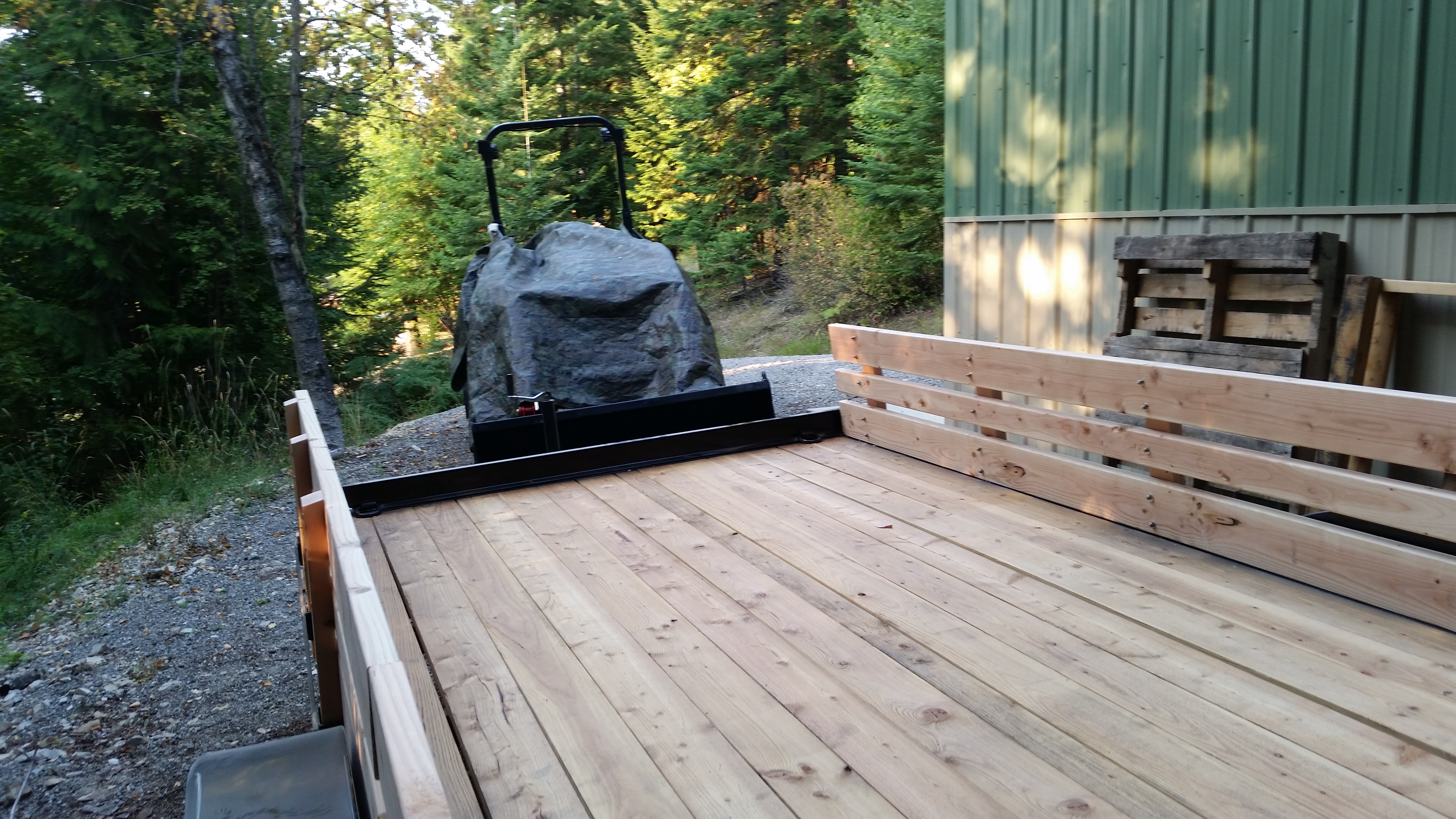

I used all treated 2 x 4 and 2 x 10 lumber when I built the sides and gate for my utility trailer. I didn't bolt it together being that there won't really be much of a load on the sides, mostly still on the bed itself, so I used deck screws instead. The 2 x 4's needed some convincing to fit the stake pockets on mine also. If you want to haul loose stuff like gravel, dirt, mulch, etc you will need an end gate. An easy fix is to install a vertical 2 x 4 at the end of the side rails, and another one about 1 3/4" - 2" in front of it to create a slot that you can just drop another 2 x 10 in to as a tail gate.

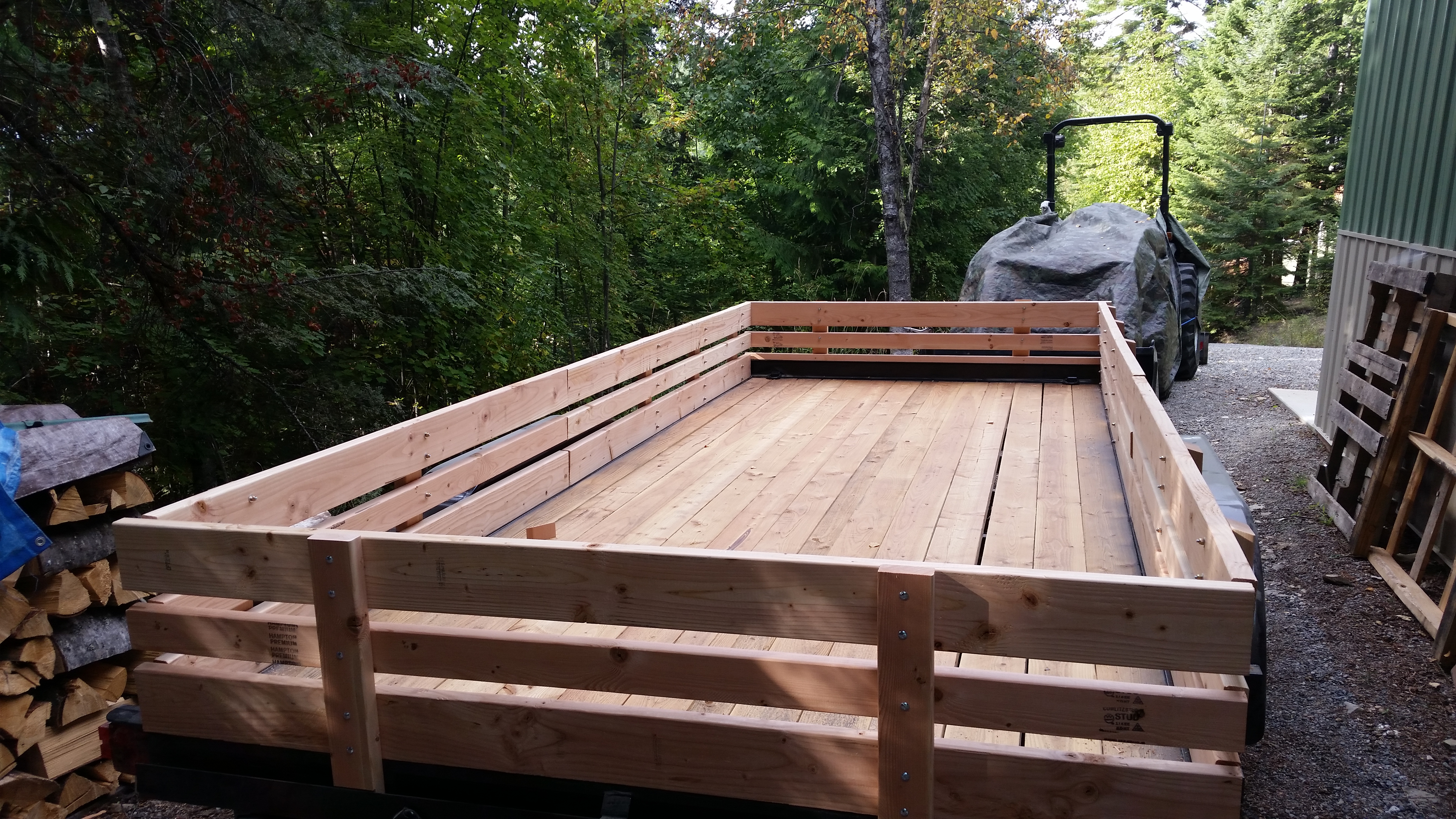

View attachment 547961 This is the farm wagon I built. Horst model 180 - ten ton frame - 5/4" plywood decking - 2"x12" side boards. I haul large rock and selected length of my Ponderosa pine trees with this. The paint color is a mix of quite a few leftover cans.
