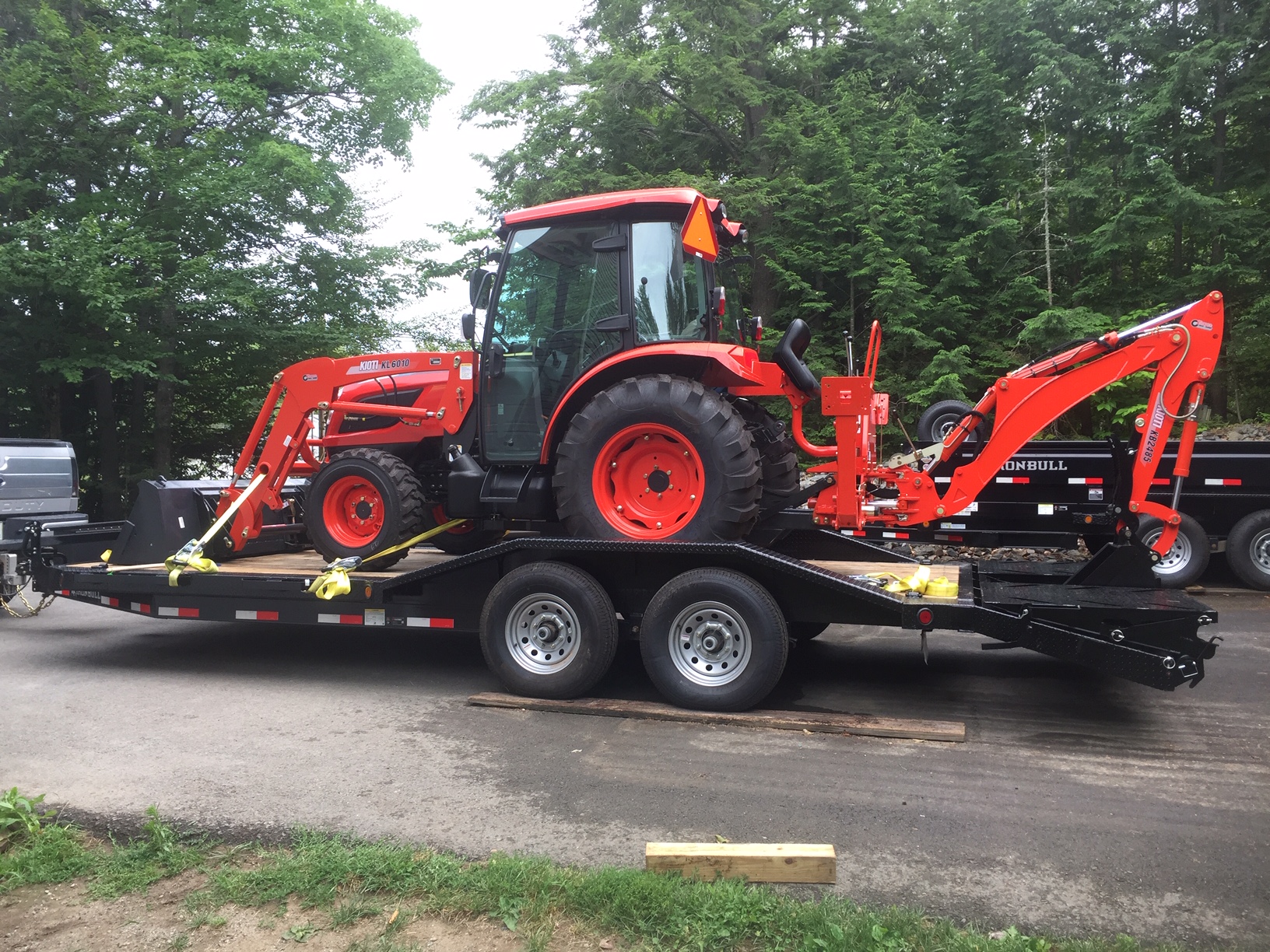

22' IronBull 14,000lb. Any shorter than 20' would have made balancing a touch harder with the backhoe attached. It was delivered on an 18' but they had the hoe swung off to the side so it would not hang off the back. I agree with the others though if you can get a bit longer you will be happier when towing. Best of luck in your search!
