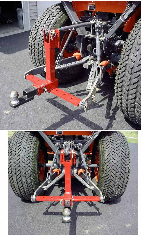

Using a 2" square tubing trailer hitch on a 3PH has been made and used by several TBN'ers.
Here is a link to one that I made. Click Here.
Just do a search for Trailer Hitch here on TBN. There are many others. There are a couple of places that sell them also.
Yours may be different than the one in the thread.

Would like to see a photo. Is it any different than the other ones we have seen on TBN? Here is a photo of the one I made.
