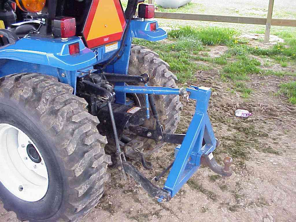

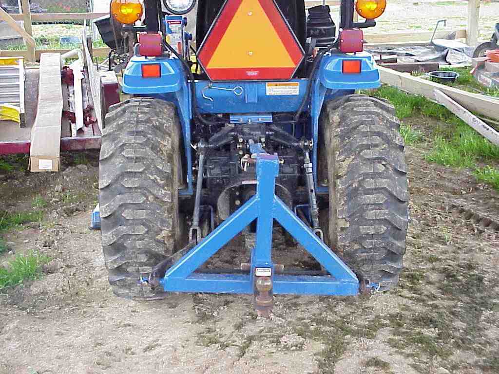

Here is the 3 Pt. Hitch Reciever that Richard made for me this past fall based upon his design. This weekend was the first time I had a chance to use it. Sure was a lot nicer then to draw bar attached to the lower lift arms and it rolling back and forth as you move. I could actually back the trailer up. I was even able to find some Krylon paint at Wally World that matched the NH pretty well.
Note: I didn't adjust the 3 Pt. Hitch to make it level as right now my MMM is level and for this I didn't care. You can see my little trailer in the background that I was using.

   / Trailer snatcher for 3 Pt. Hitch #30
Here is a few from the side.
