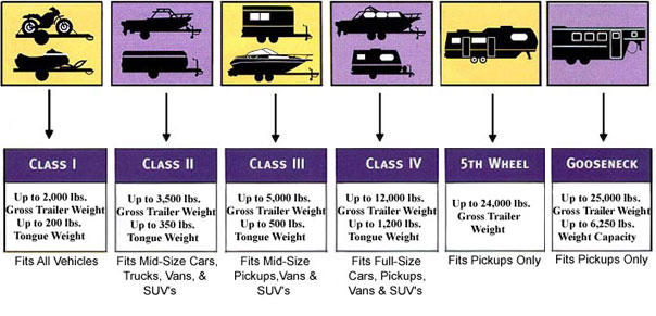

<font color="blue"> I used the local scales to set my tounge weight to 1000lbs which sinks the tail of the truck about 2 1/2 inches, the truck looks just level front to rear at that point. </font> A little disruption here. That's a lot of tongue weight. Hopefully you're running all class IV equipment including the right balls and drops. Weight distribution hitches help, but do not override the right stuff. Soapbox off. [image]http://[/image]

Your problem could be tongue weight, but I'll bet your trailer isn't level, is it. I have a 12000# MacLander, when I bought it the coupler was adjusted as low as it would go. Not too level behind a 250 Superduty 4times4. The trailer handled like crap, swaying at around 50 and jariing your fillings loose it rode so hard. This has happened before with other trailers of mine so I just kept the speed down on the way home. Broke out the wrenches and raised the coupler to level the trailer. Both your axles should be evenly on the ground. You said it looked like you could raise your ball about 2". Please try this before you go out and spend several hundred bucks on an equalizing hitch, sway control, and whatever else. I just can't imagine a truck like yours can't handle this trailer. I marked on my trailer bed where to stop the tractor when the rear of the truck sags about 1 1/2". Beleive me, theres not much worse than the way some idiots drag trailers around. Try this and let us know how it turns out, the primary concern here is for everyones safety, yours and the other drivers. /forums/images/graemlins/smirk.gif
   / Trailer Sway, any thoughts? #29
Thanks for pointing that out. I guess I should have included the fact that I had to upgrade the hitch, drawbar and trailer coupler in my post above. The stock towing package includes only a class III hitch.
I had to go with a class V hitch, drawbar etc. to get the safety margin I wanted.
What I have now does ok but I hope to upgrade to a gooseneck setup at some point. I am told they pull better and tend to be safer under heavy loads.
