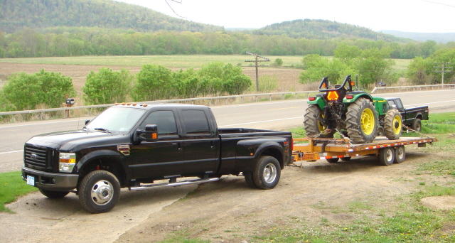

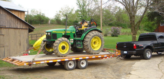

My trailer and most if not all deck-over tilt bed trailers are made that way. I have 22' Econoline 7 ton tilt.
Like everybody else has said, getting the trailer loaded correctly is key. If you can move the axles or get a different trailer. Otherwise, re-think the loading.
FYI, I did add weight distribution and sway control (Reese Titan Dual Cam), but I needed it for the weight I was towing. I recently towed ~13,500 through the hills of NE PA and she followed and behaved perfectly.
