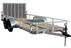

What's a rub rail? The unit I am buying is a landscape style with rails, but I don't think that is what you talking about. Attached is a picture of the unit.
Also here is a TBN link to another member (John Sr) who purchased one last year although his is the 16'.
JohnSr Trailer

THERE'S my way of doing things! With the rub rail, you always have the option of tying ANYTHING down, with no limitations as to the tye point. With almost every impliment I use/load on my trailer (behind the tractor) I place it in a different spot. (centering weight)
