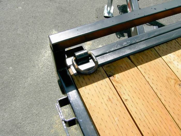

Here's a pic of the "D" rings (one on each corner), 2x4 stake pocket and the 3/8" thick rub rail on my trailer. but this is a steel trailer, not sure how you'd put them on an aluminum one since you can't weld steel to aluminum.
Oh by the way, if any one knows somebody looking for a 7 x14 7000 lb. trailer out west here...........this one's for sale.

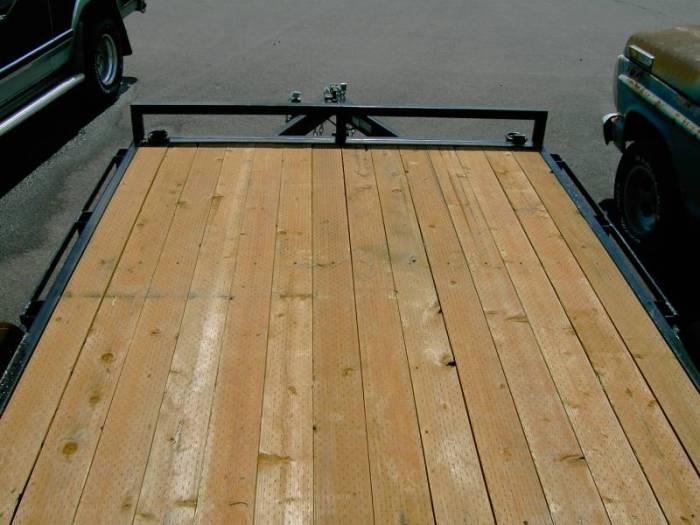

And another view........

Thanks Dirthauler, I would love to have attach points like that. That looks like a nice trailer.
