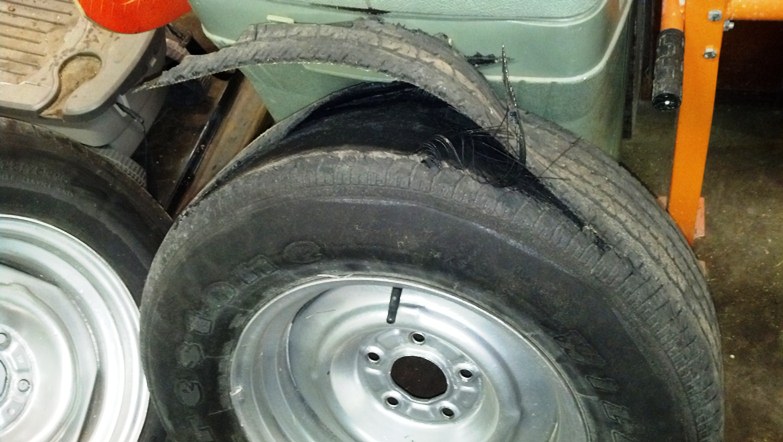

Have you checked your tire age lately? I know most of you are smarter than I am but I make up for it by being lucky.
The backstory is I bought a used 7K trailer about 5 years ago. It was in rough shape but I usually only use it for hauling within 10 miles of home. I bought it from a trailer fabricator. It had no brakes so as part of the deal I had him add brakes to one axle. When I picked it up I noticed it had two new tires, which I took as a bonus. Later I discovered it had GM 4-3/4 bolt circle wheels and when he put the brakes on he had to switch to 4-1/2 trailer hubs.
Fast forward to early this year. I was towing empty and I hit a big bump and the hitch latch failed and it jumped off the ball. The chains held, so not much damage. I put on a new hitch A-frame, heavy safety cables and, because I noticed the older tires cracking, changed the hubs, added brakes to the other axle, and put on new rims and tires. I just stuck the old tires in the corner of the pole barn.
Last week I happened to walk by and saw this. The tire blew out just sitting in the barn. I checked the tires and found they were built in 1998. Now the real scary part. Out of curiosity I looked at my "new" tires that were put on when I bought the trailer. They were dated 2000. Apparently they were new old stock and were 10 years old when I got the trailer. They still look brand new (I keep the trailer inside) but I will be replacing them before I do any more towing.

After I mentioned to my wife that I had a concern that my 37' fifth wheel camper had tires on that were 12 years old but looked like new yet she wouldn't travel in it anymore unless new ones were installed. People say 8 years is it for trustworthiness but on a regular trailer I would probably understand the risks and what the load may be and take my chances. You are right about wanting them changed to be on the safe side.
/ Trailer Tire Age #5
I don't think I've ever gotten more than 5 years out of a tire on my campers. They claim that trailer tires don't get exercised as much as your truck tires, so they age out before they wear out.
My first encounter with this was several years ago, the spare on the fifth wheel just blew out on the sidewalls (taking out a nice tire cover). Since it was late fall and I wasn't planning on any more trips that year, I didn't do anything. Before spring arrived, one of the axle tires blew just sitting there and another axle tire looked like it was ready to go any moment.
Now I replace them all every four years because I have nightmares about having a blow out in heavy traffic.

I never thought it could happen either, but if you ever asked the question "If a tire blows out and there's no one around to hear it, will it still scare the h*ll out of you?", the answer is yes.

I had a tire blow on my boat trailer sitting in the barn that was 6 years old. It was the spare and had never touched the ground. It literally blew a hole in the side of my barn. It happened 6' from my daughter's bike. Just glad she wasn't near it at the time.

My Grandpa was showing me his spare tire for his rollback that blew out just laying on the bed of the truck. It was catastrophic failure, not just a small hole. I know a guy that has such bad luck he now carries 2 spare camper tires and a floor jack.
