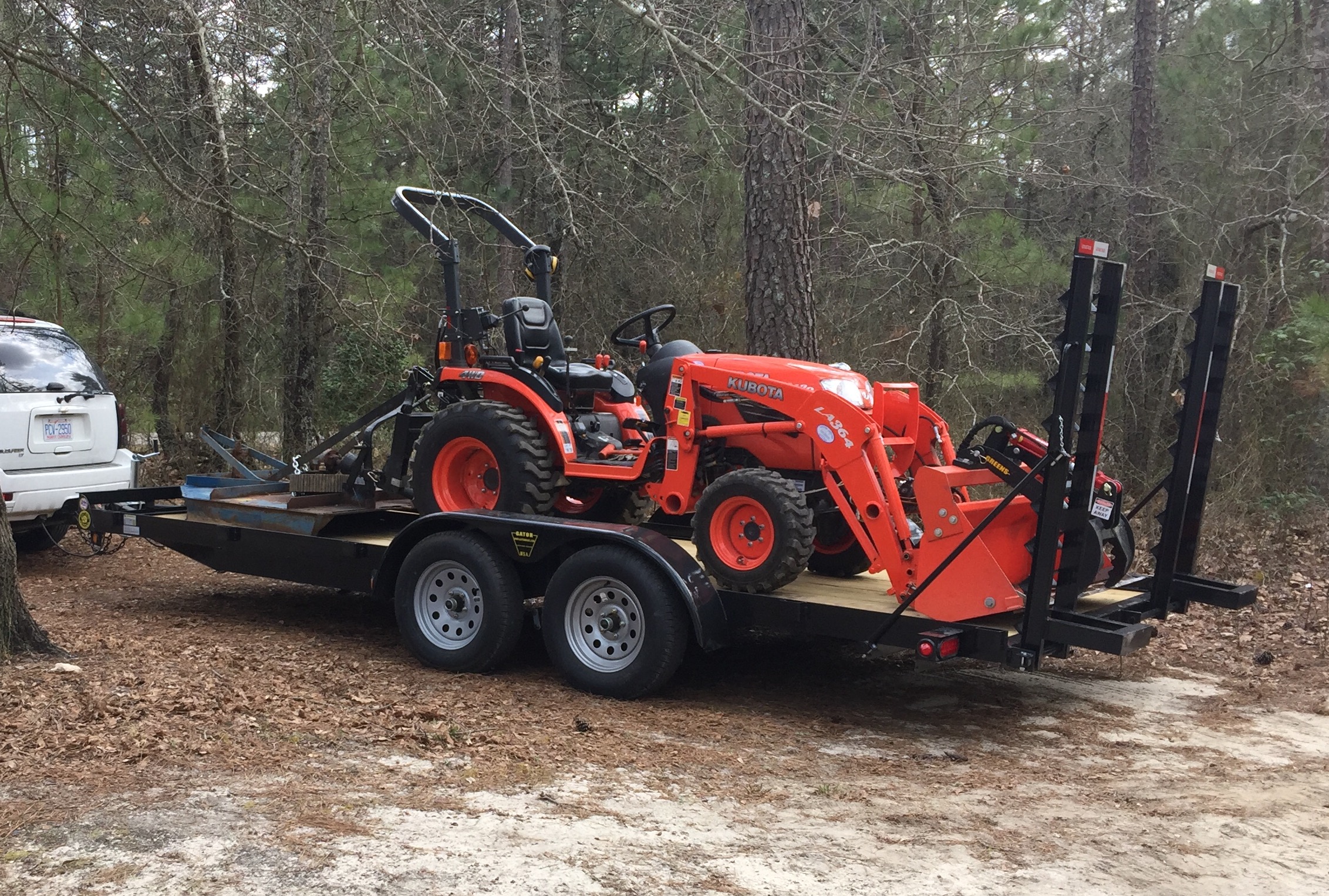

Depends on what you're doing + attachments. I use an 18' Load Trail car hauler for mine because I haul it with loader and bush hog + 800 miles twice a year thru multiple states. Poor pic but this is it: ImageUploadedByTractorByNet1470670375.772787.jpg

The specs I read on the B2320 say it's under 1500 pounds with a 61.5" wheelbase. Most landscape trailers will handle that. As Stubee says, more info is needed such as equipment/attachments and how far you intent to trailer.

I was able to borrow a 16' and an 18' trailer to try with my b2620 before I bought one. For me I liked the 18' with a bush hog and loader, it gave a little room to adjust the load to get the tounge weight right, and with anything shorter than the bush hog loading is easy.
Landscape trailers I saw in my area would be fine with just the tractor, but with loader, loaded tires and any 3-500 lb implement I felt like they were a little lightweight for what I wanted even though you see it done daily. It depends a lot on what your hauling with too, this trailer weighs about 1800 lbs.
I ended up with a Gatormade 7000 lb trailer that has worked great for me, if you have them in you area they are worth checking out. I was sure I didn't want to wrestle with storing ramps so got hinged ramps and they have dual brake axles. I got a 18' for $2200

As others have said, 18' car hauler trailer and don't look back. I like stowable ramps because I can dangle a bush hog wheel over the tail a foot or so. My tractor is a B2620 by the way.
