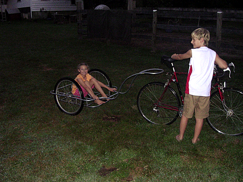

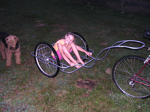

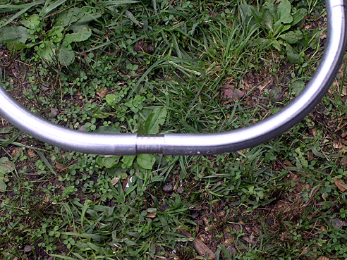

Well, here it is after successful test ride:D
   / Trailer to pull with a bike
#20

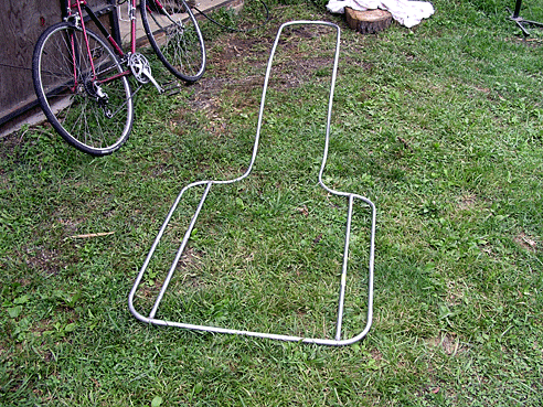

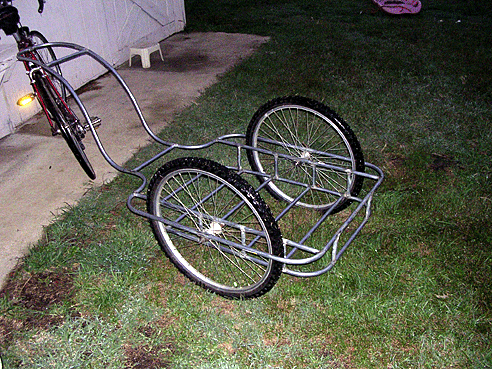

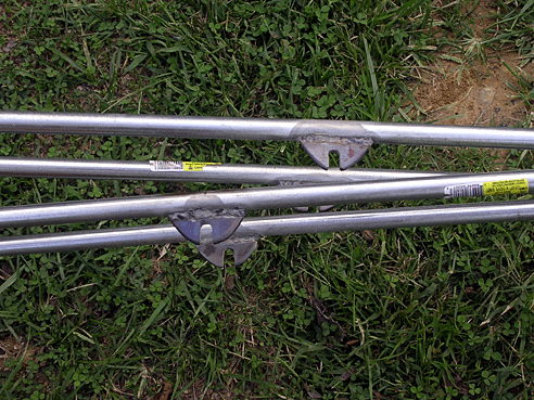

Wheels are from a bike I found at the dumb, the frame I used metal conduit (btw the bender works like a charm, could not do without it) and odds and pieces are mainly scraps from an old lawn mower.
It took some effort to get good welds on the conduit but it is pretty sturdy.

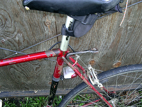

The hitch has a rubber bushing to avoid the clanking and the trailer is secured with a hole, washer and a pin.
I hooked it up to my beater bike, because it is steel, but since it hangs from the saddle post bolt, it could possible be pulled behind the full carbon too.
