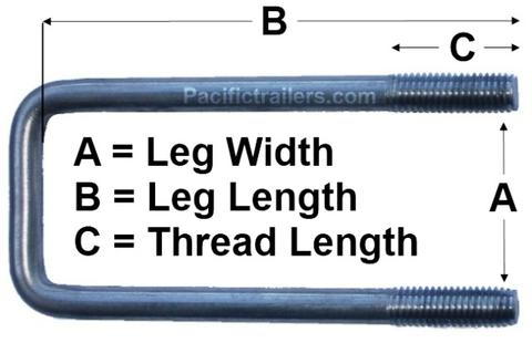

I just picked up a 16' car hauler and want to add a tool box to it but I'm concerned about how to mount it. My last flatbed had "c" channel where you could drill through the top and bolt everything down but this one has a boxed frame. I can't imagine a self tapper would be enough to keep the box in place so I'm thinking I'd have to drill through both the top and bottom and run a long bolt through the frame. I'm not the best welder and I don't want to make it that permanent (if I can help it). I've looked on line for ideas but I guess I'm not asking the right questions.
I'm open for any suggestions or ideas on how to proceed...

square or rectangular u-bolts. thru bottom of box around frame. may have to bend them your self, or make them from two long bolts going thru a flat metal bar. taht is what I will probably done for my box.

Here is another vote for square u bolts, unless you let the toolbox go with the trailer when you sell it.
Put the nuts inside the toolbox.
