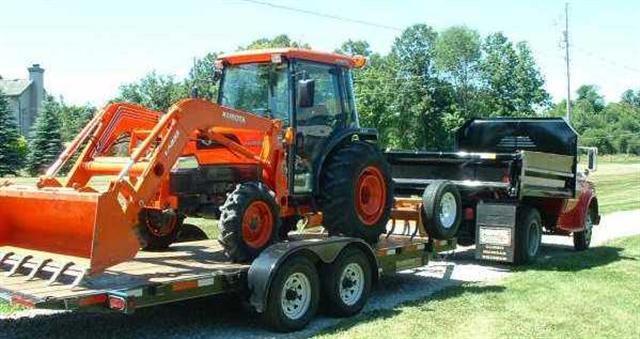

My tractor is very close in size to yours (L4330). You are going to be overloading a 7,000 lb trailer. I highly recommend a 10,000 GVW trailer.
I have also tried to get by with an 18' long trailer and it isn't worth it. My tractor with a box scraper just fits on a 20 footer with a foot to spare. With a brush hog mower on back it uses the entire length of a 20 foot deck.

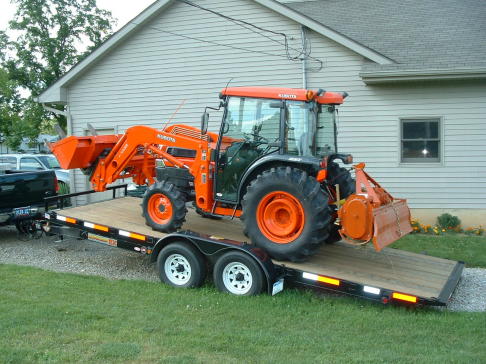

I also highly recommend the H & H tilt bed trailers. I've had mine about 1.5 years and love it. It is much safer than ramps. Because the whole bed tilts the angle that you must climb up is much more gradual. There are no heavy ramps to carry or buckle or slide off of. Once you use a tilt I doubt that you'll ever go back to ramps.

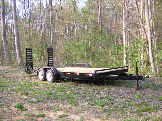

I have pulled my L3710DT with LA682 loader and loaded ag tires on a 16' 7,000 lb. gross trailer without brakes before and as you mention, it is not a confidence building exercise. I purchased a 20' 10,000 lb. flatbed equipment trailer with brakes so that I would have the capacity to move my tractor when I want to in the future. For the price difference, I would not go any smaller than this as it seems to fit well. If you want to go much bigger, you will move into gooseneck territory and get into even more money rather quickly. The other posters are right about the towing capacity of 1/2 ton pickups. However, that is all I have available at the moment. If I planned on towing such a heavy load often, a used 3/4 or 1 ton would become a much higher priority. The tilt feature does sound appealing, but the ramps were the most economical alternative for me. A picture of my trailer is attached.
