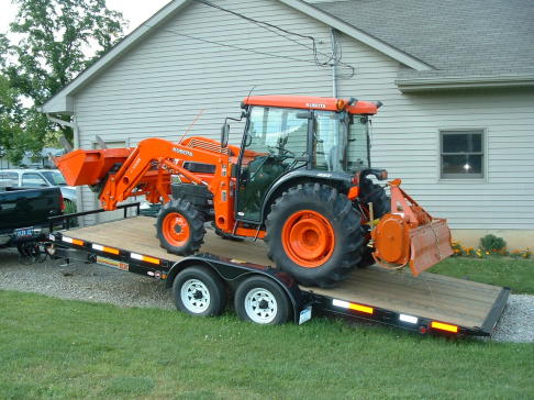

Yooper from another yooper - I looked at trailers for 2 years before I bought. Just about every trailer Dealer tried to sell me a trailer with 2 - 3,500 lb axels, even though I told them my old crawler weighed about 7,000 lb. Finally had one made with 2 - 6,000 lb axles, surge brakes, 10 ply tires, etc., only major MISTAKE was I had it made too short. Recently got a Kubota L3130 and when I move it with the Bush Hog attached, have to remove the FEL. Can move it with the Box Blade attached, but FEL hangs over front. My only advice, for what it's worth, is too get a trailer long enough (20' ?) and one with heavey enough axles to carry the load. I run Load Range E tires - if there's too much flex in your sidewalls I believe that may contribute to the trailer sway. Towing vehicle is important - every once in a while you see where the trailer bossed the towing vehicle. and it ain't pretty. A few pics to see how you have to load when trailer too short. Have fun.
penokee /forums/images/graemlins/smile.gif
/ Trailer Troubles / Decisions #31
another one.

/ Trailer Troubles / Decisions #33
With that setup and my luck, I would have teeth marks on the tailgate before I got out of the driveway! /forums/images/graemlins/wink.gif
