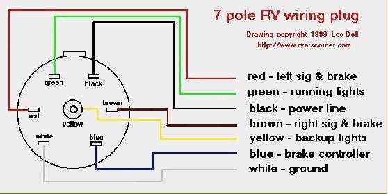

Well, the first attempt at a hookup didn't work. But then, I did just take the pigtail I bought at TSC and wired it up color to color. Right turn signal worked the left trailer light and on the rear LED bar, no running lights on the right side and Left turn signal didn't do anything. So I checked continuity between the terminals at the junction box and at the connector of the cable that hooks up to the vehicle. Their pin layout was way off compared to what GMC's is. I didn't have time to remake the connections last night due to a kid's football game but I'll jump on it tonight and see if I can't get things running right. At least now I know what colors of the pigtail need to be connected to which color of the trailer light wiring.

If you have brakes, watch the location of the brake vs. auxilliary on the GM vehicles. Any adapter or harness I've ever gotten has the auxilliary power from my Chevy going to the brakes of my trailer. This doesn't work well for pulling. :laughing:

Thanks IPlay. Yeah, I had to move the yellow, green, and brown around in the junction box but I got them to work.

When they were setting up the standard on these round 7 pin plugs, why didn't they make the center conductor the GROUND connection? It's the largest one of the bunch and it just seems that making the center pin ground then all the other light/brake connections surrounding it would make the most logical sense. It's almost like it was an after thought to even use the center pin. ("Oh wow, somebody wants to hook up their backup lights. Well let's just use the center pin, it's not being used for anything!")

I've thought that too. I don't have any answer for why the system is set up how it is. The only part of the 7 pin connection that makes sense to me is that the left turn signal is the left most pin, and the right turn signal is the right most pin.

Well it is on the truck, but not on the plug I bought!!
EDIT:
Let me rephrase that. The left/right turn signal connectors are on the left & right side of the plug, but it's the WIRE COLORS that are different from "normal" trailer wiring. I found an illustration of the pin out of the plug that I bought. Now, that's the 'standard' for the RV industry but I wasn't even aware of that until just a day or two ago. I was still thinking in 4 wire trailer layout.
And they used White, Yellow, Brown & Green wires in the 7 pin connector but they assigned different uses to them. WHY?!?!? Could they not have carried over those colors to the same use in the 7 pin that they had in the 4 pin??? Why cause seemingly unnecessary angst by changing what purpose the wire colors had?

i be remembering going through same stuff you doing now. of different colors.
i just plain gave up on color coding scheme. and got some tape and a marker. and a dc volt meter (10 bucks local hardware store), and checked what was what. and went at it from there.
i have had grounding problems with trailers in the past, so i just run ground wire to all lights, even if it means just striping the plastic back and placing it behind the screw / bolt that holds the light on.
