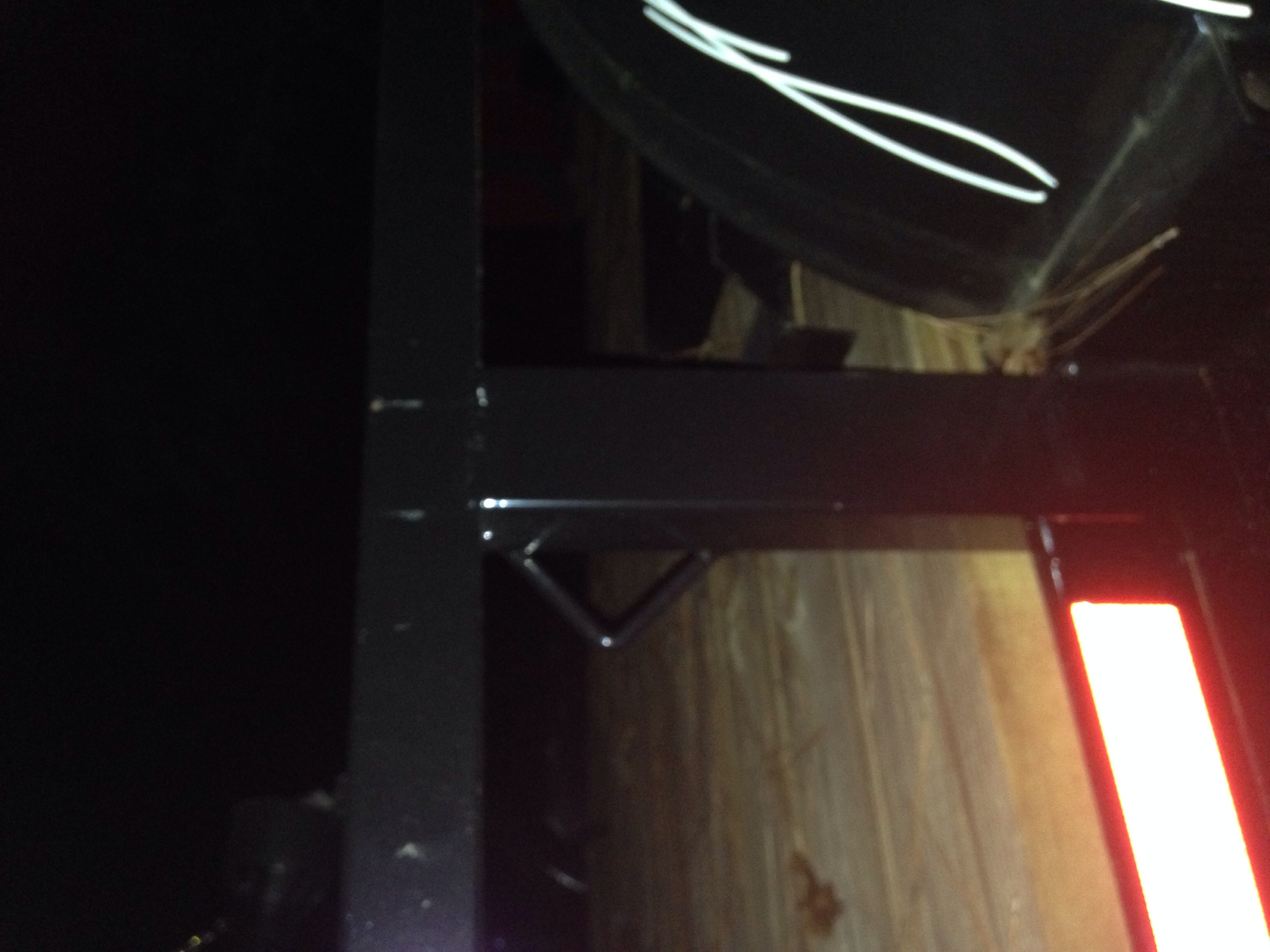

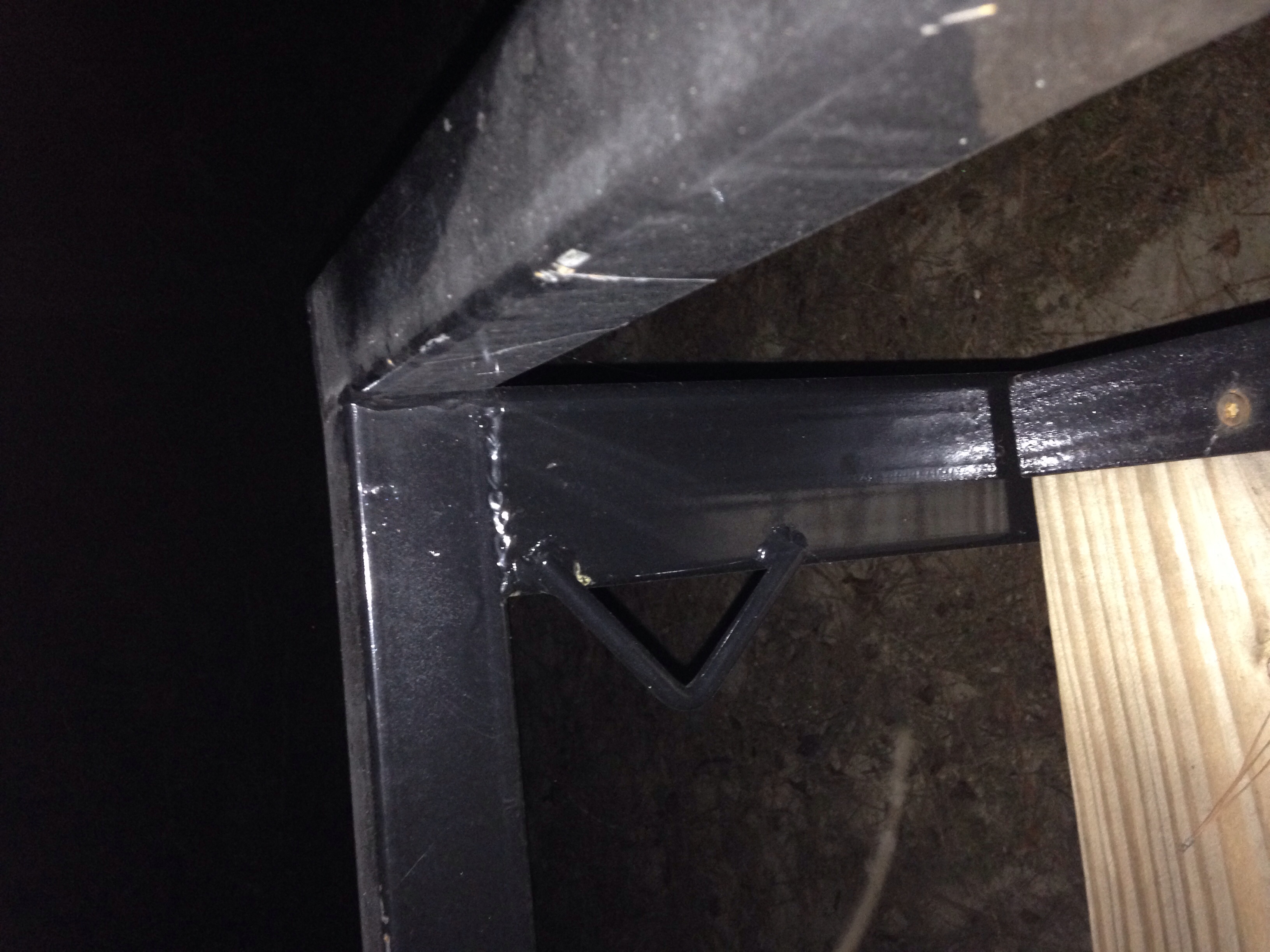

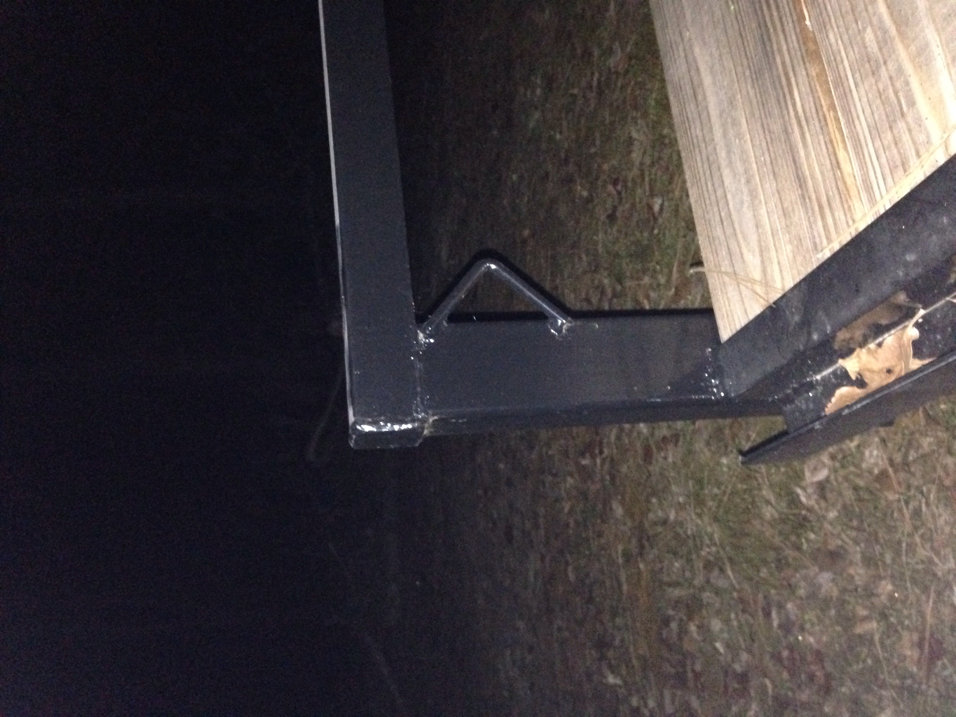

See most people on here strapping tractor down using stake pockets. I have am 18' trailer that has rails and no stake pockets. I came new with 6 tie down points not really a d-rings more like a piece of steel bent in a triangle and welded to the rail. 2 on front corners 2 on rear corners and 2 just in front of wheel well. They just seem like they would not be as strong as stake holders but maybe they are. I would guess they would be rated to at least hold the weight of what the trailer is rated for. For other people that have trailers like this have you ever had any issues chaining or strapping down to these.

Here are some pictures of them.
   / Trailer without stake pockets #7
No way I would secure a tractor to those. They look like the were intended to secure a lawn mower or something else small with light weight ratchet straps.
   / Trailer without stake pockets #8
They look like tarp tie downs and not equipment tie down points.
   / Trailer without stake pockets #9
That is the correct way. Drop hook threw and bring up and hook to the top on outside. Have hauled heavy equipment this way for years,with chain and binders.
Those are the only tie downs on the trailer. Why would someone build a 7,000lb trailer and weld tie downs on it that are not strong enough to hold a load the trailer is rated to haul. The only other option would be to go around the rail which I don't like to do either.
