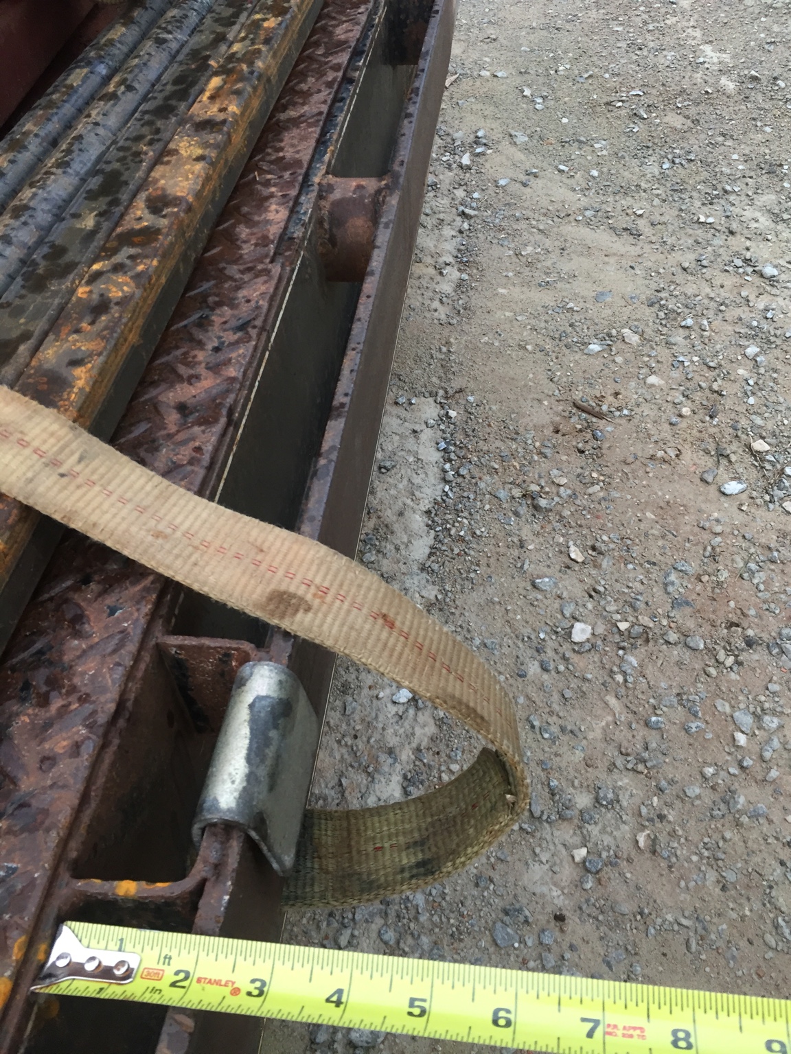

See most people on here strapping tractor down using stake pockets. I have am 18' trailer that has rails and no stake pockets. I came new with 6 tie down points not really a d-rings more like a piece of steel bent in a triangle and welded to the rail. 2 on front corners 2 on rear corners and 2 just in front of wheel well. They just seem like they would not be as strong as stake holders but maybe they are. I would guess they would be rated to at least hold the weight of what the trailer is rated for. For other people that have trailers like this have you ever had any issues chaining or strapping down to these.

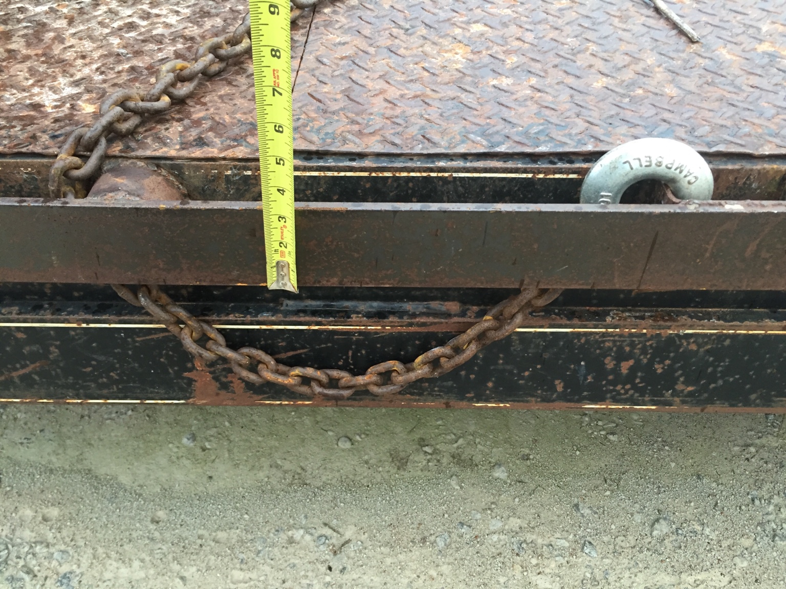

I have never seen to many tie down points :) Have rub rails and pockets welded on. Not just the sides, front and perhaps even the back. The pockets shown are just right for 2 X 4 stakes. You may need a bar or stop under them to keep the stakes from falling thru, not sure how you're Trailor is built. The round pipe spacer idea lets chains or straps slide easy and not have sharp edges to deal with if needed. The stake pockets are also big enough to allow strap ends to pass thru and be hooked back up. Straps and chains hooked up as shown will still not come loose if slack in the line happens. Hooking under a rail allows them to fall loose. Rail height is important. If the metal strap for the rail is to narrow then it does not allow the strap or chains to wrap around nicely. IMG_6820.JPGIMG_6821.JPG
/ Trailer without stake pockets #29
Those pipes in the rub rail are chain spoils and are the best place to hook a chain if using one.

I called Lawrimore today and they said they were rated to 5,000lbs. Not sure I buy off on that but that is what the lady I talk to said.
/ Trailer without stake pockets #31
I agree, find a local welder and tell him what you want to do with the trailer. He will know what to do with that info.
