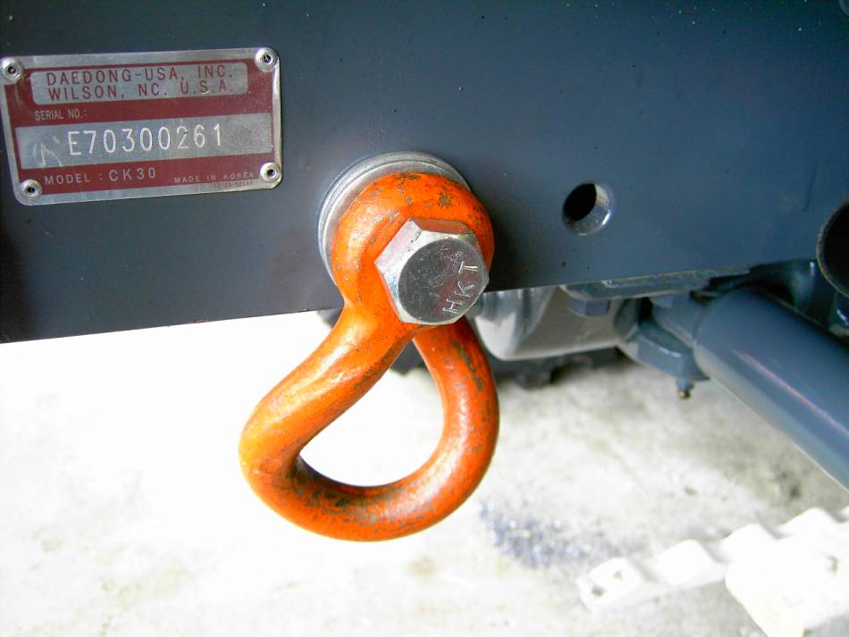

Yes, it is up to interpetation. I went directly to the CHP Commercial Enforcement(takes care of all towing issues) and asked them after reading the Fed rules.
They were very specific that if they checked out my rig, they would expect a chain/binder or ratchet strap on each corner and a chain or ratchet strap over the implement.
The CHP were pretty nice. I called and asked them about it, told them I was getting ready to trailer my tractor and wanted to do it properly.
I USED to set a chain/binder on the back, set from one trailer tie, through the drawbar, to another trailer tie on the othe corner. Did the same up front. Turns out, I was wrong /forums/images/graemlins/blush.gif It was not moving, but if on chain or binder would have failed, the tractor would have been able to roll all over...
   / Trailering a Ck30 #23
This what I put on my CK30, I just opened up the holes from 18mm to 3/4" (3/4" bolt & nut), used flat machine washers to space the "twisted" shackles evenly on both sides of the frame. Run the chain thru them and cince 'er down. I used this same set up on the CK20. /forums/images/graemlins/wink.gif
