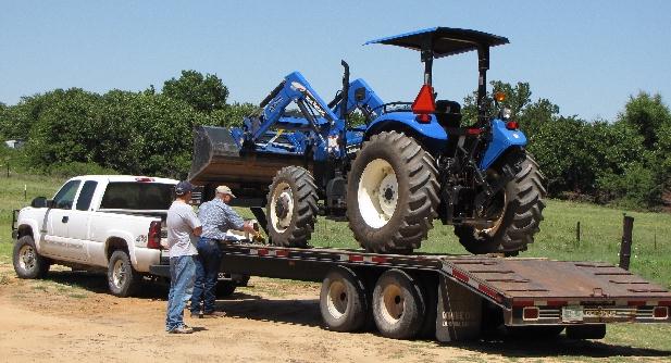

Looking to buy a traded-in TN75S from a dealer 3 hours away. Haven't seen the unit yet, but I wanted to take a trailer in case I decide it's a good deal and take it home.
Anybody have the dimensions/weight of this tractor?
It has a Quicke 720 front loader.
Here's a link with picture.
You may want to consider a trailer similar to this one for a similar tractor.

According to the specs I have the open station TN75S-A with FWD weighs in at 5585 lbs and the cab version weighs in at 6050lbs. Add about 1200 pounds for a loader and your looking at 6755 to 7250 bs. The top of the rops is 95.1 in and the top of the cab is 90.8 inches. ROPS folded height is 75.1 inches. Overall width is 67.2 to 92.7( depends on wheel positions). Overall length (no loader) is 154.9 inches.

Thanks, all. My Chevy C1500 just doesn't have the muscle for a 12,000lb trailer. Dealer's gonna have to deliver.
