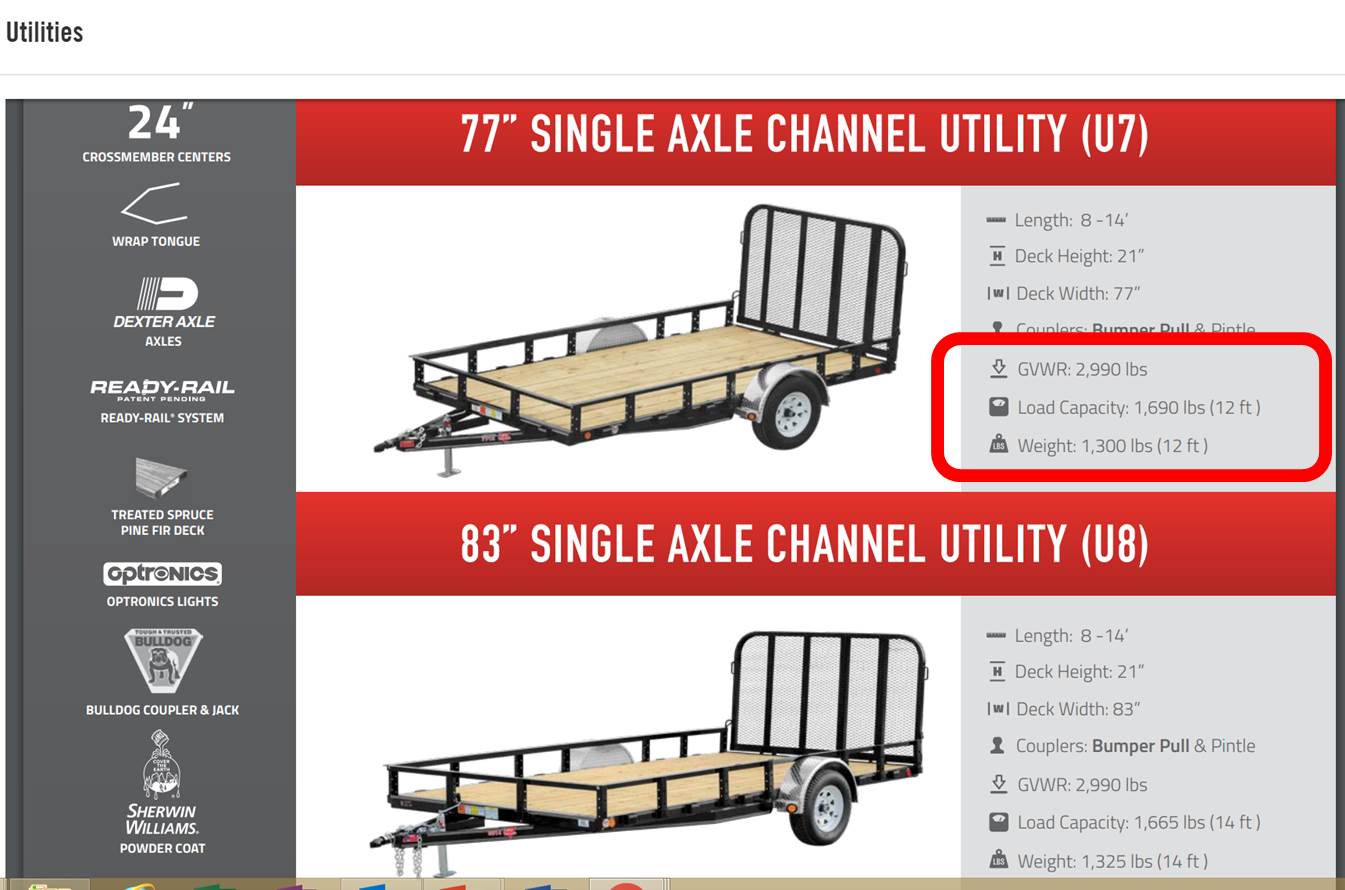

I am wondering if anyone on here is trailering their B2650HSDC on a single axle trailer. I am looking at a PJ U7 with 5200# axle, 14 foot in length. I do not plan to trailer the tractor often, maybe once every couple of years, the primary use of the trailer is other utility purposes. I know that trailer will handle the tractor weight wise, I am just wondering if I will be able to position the tractor on the 14 foot trailer to distribute the weight correctly to the axle and tongue.

I am looking at a PJ U7 with 5200# axle, 14 foot in length... I know that trailer will handle the tractor weight wise
Out of curiosity, I looked up the specs on this trailer and wanted to point out a couple of items just to make certain you don't regret something later. It's also very possible the published data is wrong or incomplete. I always like to make 100% certain the facts are correct before paying $'s.
Please reference the attachments.
1. Are you certain you can get the higher capacity axles in the U7? They appear to only be an option on the U8.
2. Not certain how you define "I know the trailer can handle the weight", but it appears the standard U7 does not have enough capacity to handle the 2650 cab as the weight limit is exceeded. Assuming stronger axles are an option (see 1 above) does the rated capacity also go up? I'm guessing the registered weight class would have to go up also and this will dictate the legal weight limits. Is the published usable capacity based on axle rating or chassis design? The base 2650 cab weighs 2293 lbs without any implements.
Don't take any salesperson's word... Get it in writing!
I'm not saying your wrong, but I felt obligated to point out there is conflicting published info. I like to know that I'm within specs/laws to minimize liability should something go wrong.

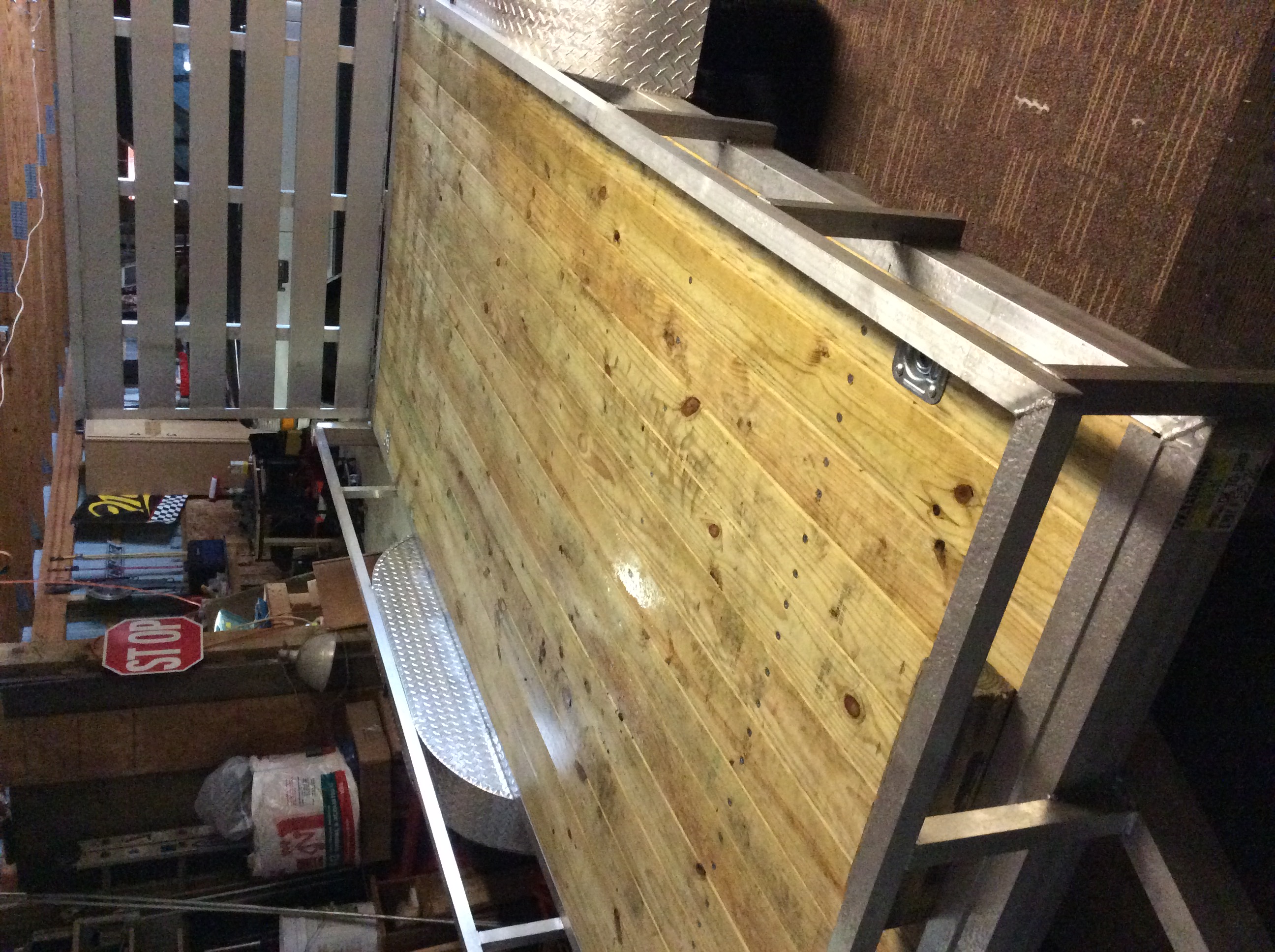

3) You pose a very interesting question about length and space to load the tractor to get the desired tongue weight -- I have found a surprising (and never explained by the manufacturers) difference among trailers in terms of where the axle or axles are placed relative to the long dimension of the trailer. Some have the axle/axles very far to the back and others more to the middle of the load bed. In my opinion you will have no trouble getting optimum tongue weight using a 14ft trailer. Your entire tractor is only 8' 5" long so it will be no problem to get the c.g. of the tractor well forward of the axle no matter whether the axle is mid-bed length or further back. Notice in the picture below of my trailer, it happens to have the axle more towards the rear rather than mid deck. That makes adjusting tongue weight quick/easy.
