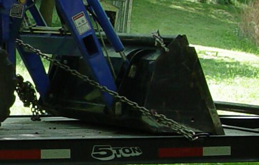

Here's a cropped picture of one corner of my TC 33 tied down. My 5 ton trailer came with four ( one on each corner ) factory welded on "D" rings. I plan to add a couple more later. As you haul the same piece of equipment configured differently (ie back hoe on / back hoe off, front loader, tiller, box blade, etc. ) you see that maybe a tie point could be placed somewhere other than where it's at.

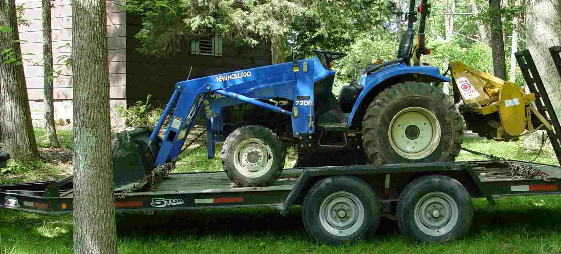

Here's one more. Had to experiment with getting the file size down below 100k.
