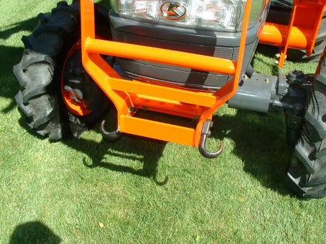

My tractor didn't have a good place to chain it down to so I added these bolt on hooks.

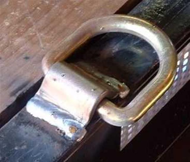

I would also recommend welding on D-rings if your trailer doesn't already have them. It only takes a few minutes to weld on heavy duty ones like these that you can buy at TSC.

</font><font color="blue" class="small">( My tractor didn't have a good place to chain it down to so I added these bolt on hooks. )</font>
I did the same thing Gene, makes it pretty quick to chain down.
