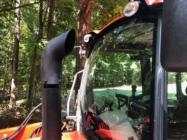

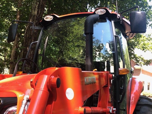

Problem Solved! I unscrewed the 3 screws holding the exhaust end on, rotated until the screw holes lined back up which 2 out of 3 did and made 1 new hole. Screwed back on and done. There was no way I was fooling with putting a sock over that every time I trailer it. Now it faces to the rear. No wind or rain will be forced down when trailering. I like this look better as well. Not sure why Kubota doesn't do this angle from the factory.
View attachment 619233View attachment 619234
My tractor came from the factory with the stack pointing to the side away from the tractor. It now points forward, because those of us without cabs would be breathing more exhaust if it pointed to the rear and my manual says specifically to rotate the exhaust stack forward if I have a loader to avoid the loader arms. YMMV
