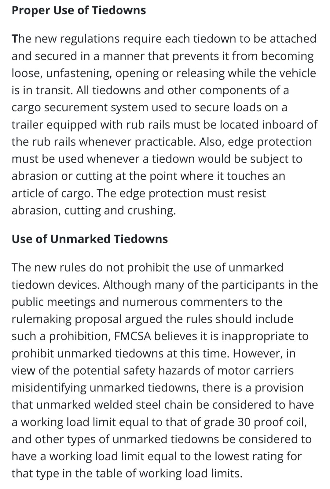

I have heard that the lever style binders are no longer legal (federally) for commercial carriers. Federal regs do not apply to non commercial carriers although some states may use them as guides.
Do you have a source?
Everything I can find just goes off of the rating (ie: doesn't matter the type of tie down, just has to be properly rated), if it is not rated, it is assumed to be the lowest rating for that size device, so a unmarked 3/8" welded link chain would be assumed to be grade 30).
There are some State agencies who have chosen not to use lever binders, but that's probably due to the costs of workers comp cases from employees getting injured by them.
FMCSA rules do require that whatever you use to secure cargo not be able to loosen or release itself in transit.
Source: Cargo Securement Rules | FMCSA
