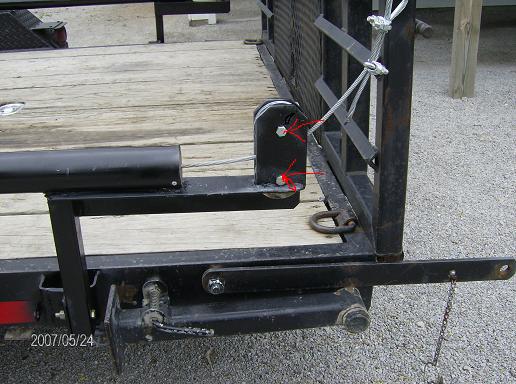

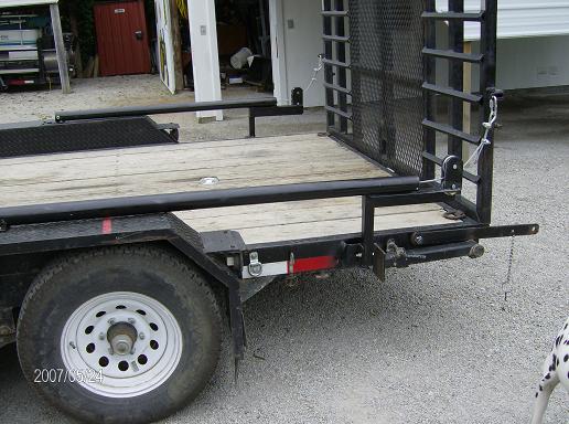

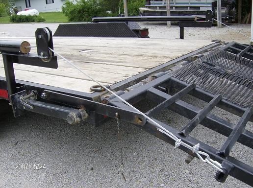

You do know about Gorilla-Lifts for the heavy tailgates, right?
Very handy but I have been making my own now for the last few years. Just need 2" dia gray electrical conduit, end caps, 2 garage door springs, and 4 u-bolts to hold the whole assembly down.
Chris

I made mine with steel exhaust pipe tubing;

   / Trailers With Equipment/Landscape Gate #30
Same idea. Very nice job. Just need something to contain the spring and cable, especially if it decides to let go.
Chris
