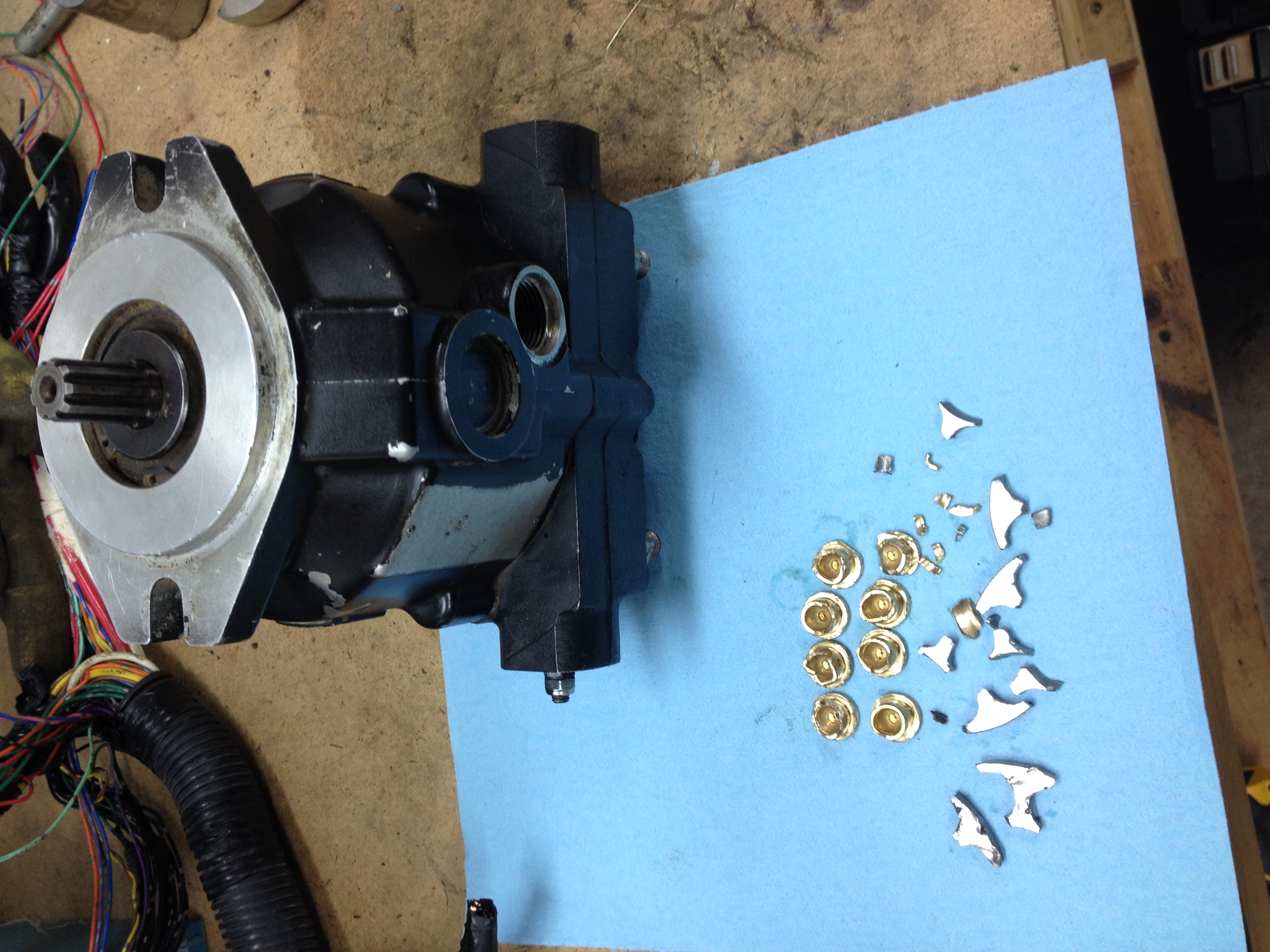

Terry says cracked cam plate. Pump repaired and on its way back... At least it was a quick turn-around.

Well, well.... Unfortunately I have to bump this thread to the top.
I was turning over the compost pile with the bucket and heard a snap from the back. No drive, but the aux circuit works, so I figured it wasn't the input shaft to the pumps. Pulled the tram pump out and hear all kinds of rattling inside.:thumbdown:...
450 hours on the machine, 270 hours since the pump was rebuilt by PT. Off to Tazwell again :mad:
This is what I was able to work out of the pump:

Oh boy, ya that doesn't look good for the pump. I think those parts should be inside, and probably not so many of them.
