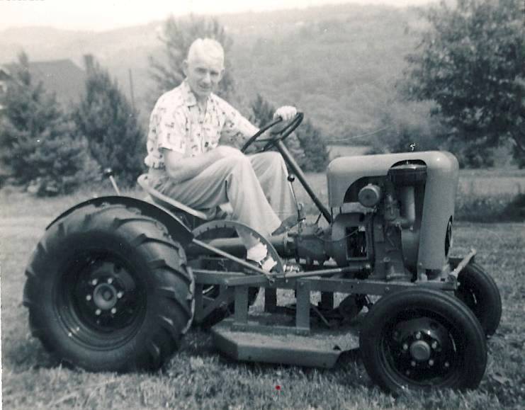

I attached a picture of the 1957 that I had (my Uncle driving).
