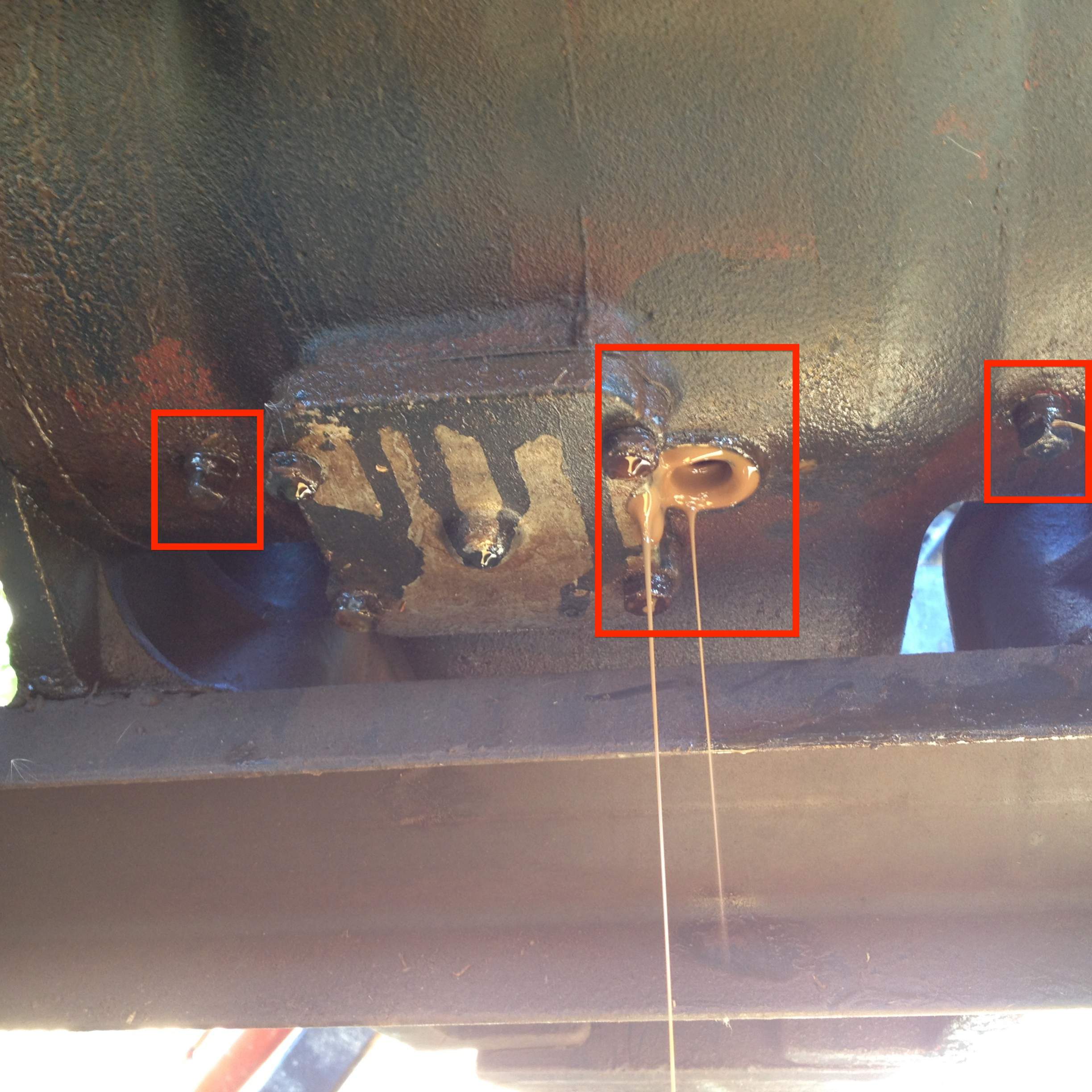

Ok so I went to change the oil, and underneath I found 3 plugs.
The two on either side of the middle larger plug had nothing to plug (nothing drained out).

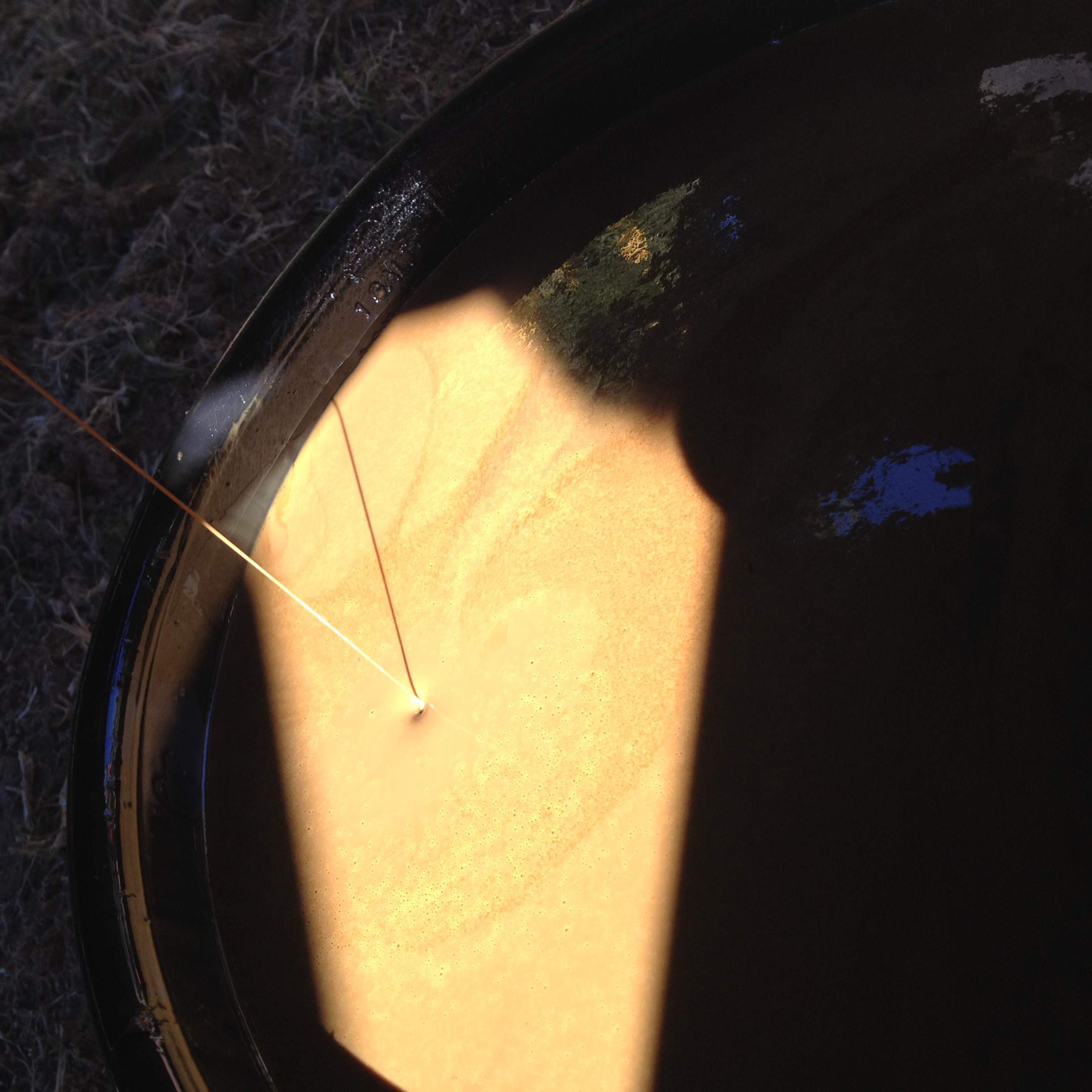

The middle one gave about 3 gal of a caffe latte colored oil.
My question is Those two plugs are (guess here) for the rear axle differential while the middle is for transmission (?) Also ,
what do you make of that Color??

If your tractor hydraulics uses a common sump with the the rear axle, you should not use an AW series oil. It's strictly a hydraulic oil that won't do the gearing any good. You need a UTF type oil (Universal Tractor Fluid). You owners manual should specify the oil in the rear axle/hydraulics and the transmission. They are often the same type oil.
The AW series are strictly hydraulic oils used in "pure" ( not drive gears or transmissions) hydraulic systems
