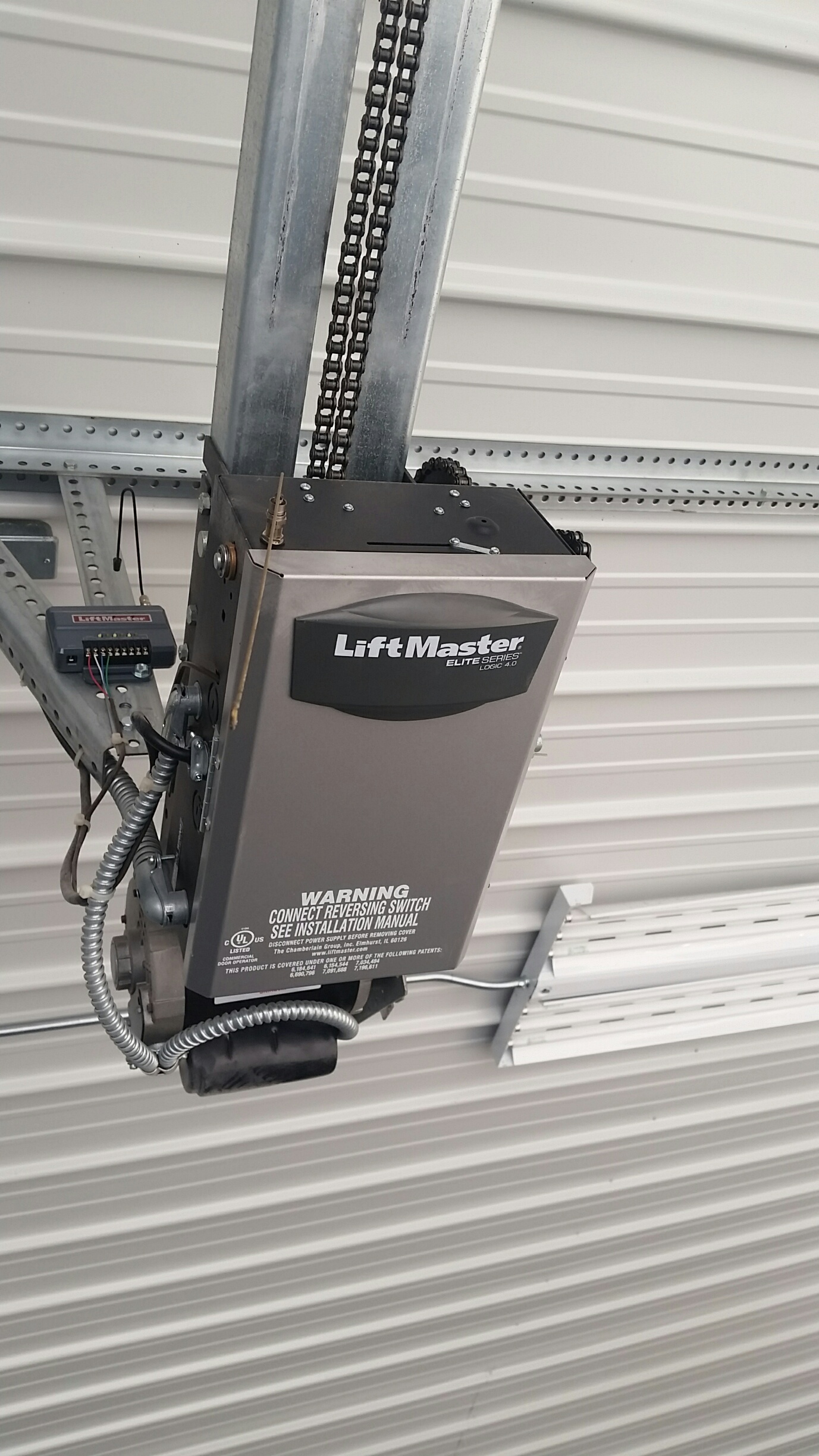

How difficult is it to install one?
My door opener in the tin shed is plugged into an outlet on the ceiling. It is 15 feet high and I can't get up there to plug in a drop cord from a generator when the power goes out.
I would like some sort of transfer switch mounted beside the breaker box so I can plug in a 2000 watt generator to open the door so I can get the tractor out.

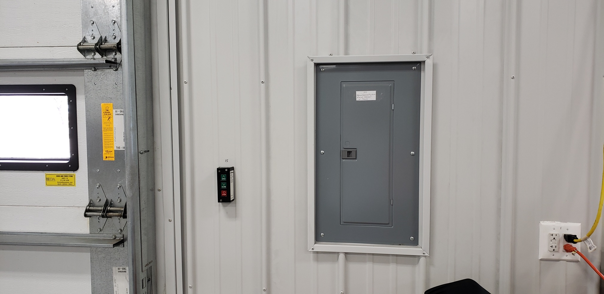

For that purpose, I would go MUCH simpler.
I would rewire the opener to be on a cord (maybe just an extension cord) that comes down to where you can reach it easily. Install an outlet to plug it into. If power is out, unplug it from the wall outlet and plug it into the generator. This could be done for $50 or less. Any transfer switch will cost at least double that and may require professional installation if local code requires it.
   / Transfer switch #3
The circuit for your opener feeds from somewhere at a reasonable height. Instead of feeding that circuit from the panel exit the panel to an outlet. You can put a plug on that circuit then plug it into the outlet. When power fails simply unplug that circuit and plug it into the generator.

I should have added, this is not a residential door and opener. The door is 12 x 24. I tried to open it when the power was out, it's so heavy, no way anyone can open it manually. It is a steel insulated and only 6 years old with annual servicing.
I called the installer, asking about a battery backup but they don't make one for a commercial door like this one.
I like Diggin's idea of a hanging drop cord, cheap fast & easy. But I would prefer a more professional look to it......depending on the price. If it's $1000, forget it, if it is half of that then okay.

You could get an industrial grade 20a double pole double throw switch at HD for about $45. Mount it in a standard 2 gang box. Wire the up position to the grid power. When in this position, the down position is dead but the operator is powered. In the down position, wire a cord with male plug for your generator. In this position, the grid side is dead but the operator will be powered. Basically a really cheap transfer switch.

I'd find the breaker that it's fed from, then pull the wires out of the side of the box.
Then I'd mount an outlet box next to the panel and wire that new outlet onto the now empty breaker.
Then I'd run that wire that I pulled out into a new j-box, wire nut it to a 1' flex cord, out the side of the j-box, and plug it into the new outlet.
You want grid power, leave it plugged in.
You want generator power on the door, pull the plug and plug it into an extension cord and out to your generator.
I'd probably use twist-lock plugs as well.
I think that's an on/off switch and you'd want an on/off/on switch.
   / Transfer switch #10
That is exactly what a double pole double throw switch is. On in up position, off in center, on in bottom position, Break before make.
