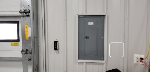

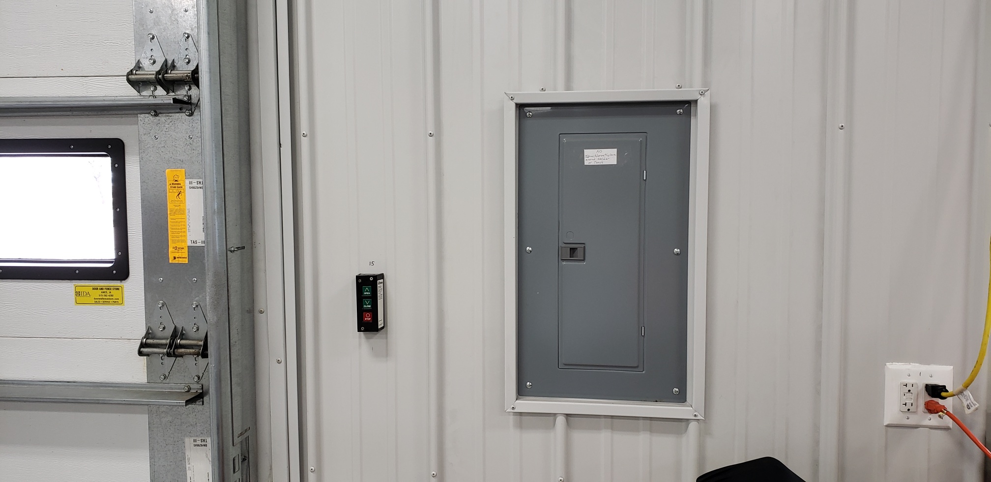

Here is a pic of the breaker box.
Just to make sure it isn't an easy job, it is surrounded by 2x4's and covered with metal.
This is one of the reasons why I asked about installation difficulty.
What do you think? Attack it or hire it out?

GAAA! You're building is too pretty to hack up.
Thanks Moss... That is why I am considering spending a dollar to do a nickels job. But I hope that hanging a temporary drop cord doesn't become permanent.
   / Transfer switch #16
Yeah, I was thinking staple gun and extension cords. :laughing:
