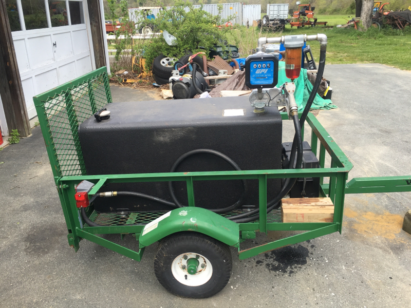

Got the 12v GPI 15 gpm pump and GPI meter all plumbed and mounted up today. I ended up going with the Goldenrod 496 filter/separator. I used stainless fittings for the install and used a coupler to mate 2 lengths of fuel hose. I just filled up the 3930 and boy what a difference over the manual hand crank pump. I'm very pleased.
   / Transfer tank water separator recommendations please, just got a new GPI 12v pump #23
Got the 12v GPI 15 gpm pump and GPI meter all plumbed and mounted up today. I ended up going with the Goldenrod 496 filter/separator. I used stainless fittings for the install and used a coupler to mate 2 lengths of fuel hose. I just filled up the 3930 and boy what a difference over the manual hand crank pump. I'm very pleased. <img src="http://www.tractorbynet.com/forums/files/owning-operating/417061-transfer-tank-water-separator-recommendations-image-534814145-jpg"/>
Looking good. Now I am wondering why I went cheap on my pump not having a meter. I never learn - use a lower cost version first, then pay all over again to do it right.

This 12v pump was worth every penny, I picked it for $237.50 on sale, $100 for the meter on eBay and $40.00 for the separator/filter.

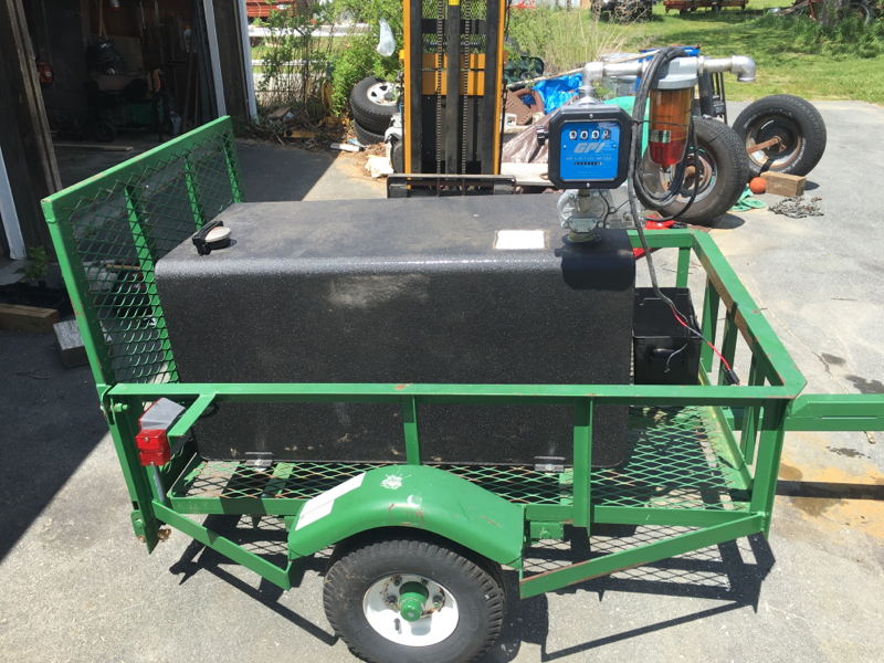

Figured I'd update this thread, I upgraded to a 108 gallon transfer tank, otherwise same set up.
