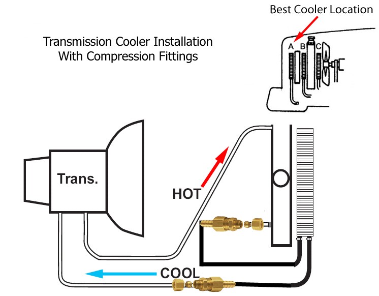

Got a question, maybe someone can help. 2005 silverado 4.3, auto....truck does not have a tranny cooler other than lines going into radiator. Which line do I need to run to the tranny cooler and then back from cooler into radiator? I'd like to keep the radiator as part of the tranny cooling.

It does not matter. One line is the line in and one is out. Your rad has a smaller cooler in it already it sounds like.
That said though I would install it in the return side so you get one last chance to cool prior to going back to the tyranny. If done the other way around it may actually work in reverse in extreme occasions and heat the fluid up by pulling heat from the coolant as a heat exchange.
Normally the transmission cooler is installed before the water radiator, not after. I don't really know why, you can find 50 opinions on the Internet, but the way it is done from the factory is usually trans -> trans radiator -> water radiator -> trans.

Here is a diagram I found from derale tranny cooler site. Does anyone know which is the return line for sure on the chevy? tranny.jpg

Yea, looks like there are two trains of thought on this one. Some say before and some say after.
As for which line the last one I did was on a Ford and the one on the drivers side was the return. I would look at the lines or the side of the tranny where they attach. Most I have worked on have been labeled. You can then follow the lines. Another messy way to do it is take both lines off and have a helper start the truck for a second. The one that pumps fluid out is the pressure/feed side.

If I start the truck first thing in the Am and let it run a short time, one line should be warmer than the other, right? The cooler line would be the return, right? Just trying not to open a lines up and make a mess.

I dont think you will be able to tell . What it matter anyway? You will have to open the system and will make a mess sooner or later.
