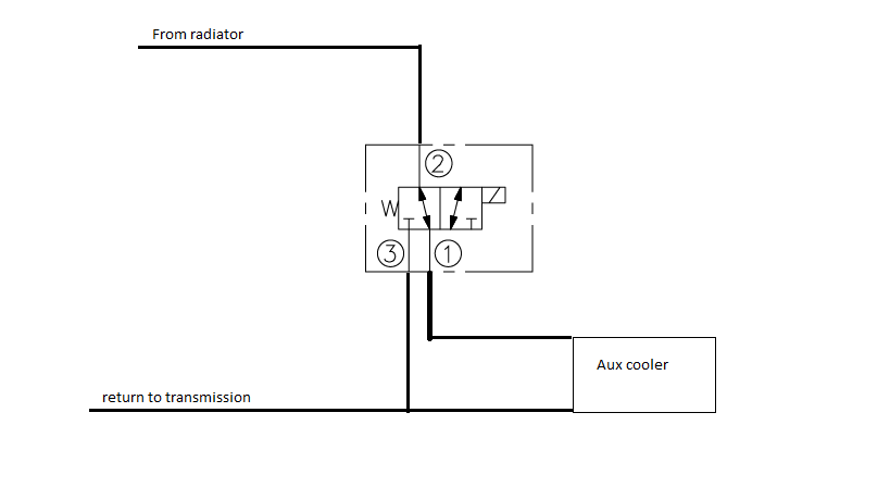

I would say according to the picture the bottom line is the return line
That was not a Chevy specific picture.A diagram how to plumb the cooler in. Time to make a mess in the morning and get it and the Timbrens installed
Here is an idea for you inventive guys that need cold weather start up but max tow cooling. Add a 3 way electric solenoid to line coming out of radiator going to the cooler. In normal heat/working condition it will go through radiator then through Aux cooler. For cold start up, flip a switch and by-pass so oil goes back to transmission by-passing the Aux. cooler.
