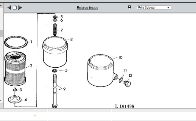

Anyone seen a JD 2950 without the spring in the filter housing?
#4 is there, but doesn't appear to be spring loaded. When I put the filter back up, there is no resistance and now I'm wondering if the filter is actually sealing against the top of the transmission housing....
   / Transmission Filter Housing #2
I would think it's not sealing without it, that's something that needs to be addressed sooner than later
   / Transmission Filter Housing #3
Ditto spring needs to be present for any filtering of oil to take place.
